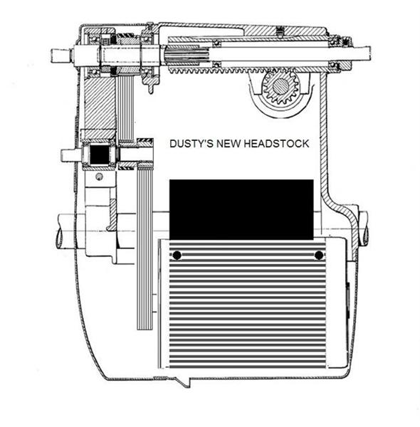

Dusty's New Headstock
This may be the closest I ever get to a PowerPro.
[ATTACH]9214[/ATTACH]
I wonder what the variable speed mechanism looks like.

When you look at Tool Hunter's depiction of the new PowerPro you see two black areas. One directly above the motor and the other on the idler shaft. What are these?
Also, if we can take these images as being close to reality, the idler shaft depicted there is shorter than the one I just received (pictured earlier in this thread). Also, the pulley that services the upper part of the second poly-v is larger than the other pulley. This would imply to me that the two shafts are NOT rotating at the same speed.

dusty wrote:When you look at Tool Hunter's depiction of the new PowerPro you see two black areas. One directly above the motor and the other on the idler shaft. What are these?The area above the motor is probably meant to represent the location of an electronics package. I do not think the black area between the bearings means anything.
Also, if we can take these images as being close to reality, the idler shaft depicted there is shorter than the one I just received (pictured earlier in this thread). Also, the pulley that services the upper part of the second poly-v is larger than the other pulley.Look again! They appear to be the same size to me. The cross section views are opposite(top/bottom) but the dimensions are the same.<<EDIT-Or are you comparing the idler shaft pulley with the main shaft pulley?-EDIT>> This would imply to me that the two shafts are NOT rotating at the same speed.A little extra length would not hurt and for all we know that is a liberty tool hunter took. Perhaps newer versions will be 'shorter'.
