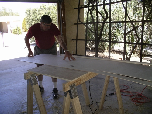

A 7 1/4" blade can be made to work very well. When we first bought in Green Valley I had to make several alterations including a few kitchen cabinets. This table saw cost me about $60 including the horses and a better blade than came in the circular saw. I used it in this mode and on a hinge in cut-off saw mode for two winters before I discovered the SS cult. I won't be going back but it did do some good efficient work. And It's as accurate as you want it to be.
[ATTACH]10010[/ATTACH]
Paul M
Paul M
- IMGP3082.JPG (175.25 KiB) Viewed 3552 times
