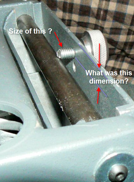

JPG, could you provide these two dimensions. tia!
[ATTACH]13223[/ATTACH]
Peter
prmindartmouth wrote:JPG, could you provide these two dimensions. tia!
1/2" from the edge. Centered L-R.
The knob was a Model 10 table height lock that had a broken brass stud. I removed the brass stud and replaced it with a steel cut off 3/8-16 screw. the conical end was ground/filed.
I would not use this without beefing up the thin web that the screw is in presently. It served as a prototype/conceptual experiment. My thinking is a 1/4" aluminum(or steel) plate that continues the threads already in the web.
P.S. The 'extra' tapped hole was a 'goof'!
