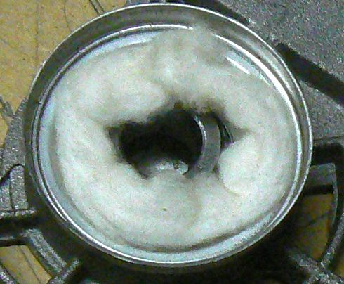

[ATTACH]12507[/ATTACH]
A cover that goes over the entire bearing housing.

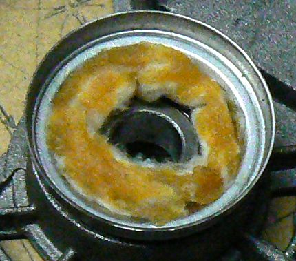

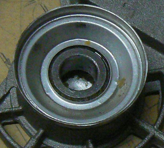

[ATTACH]12508[/ATTACH]
Added cotton.
[ATTACH]12509[/ATTACH]
Cotton 'oiled'.
Added cotton.
Cotton 'oiled'.
I did not take a pix of the cover installed.
