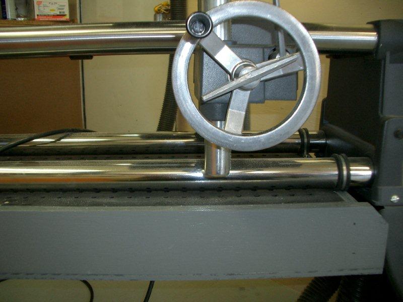

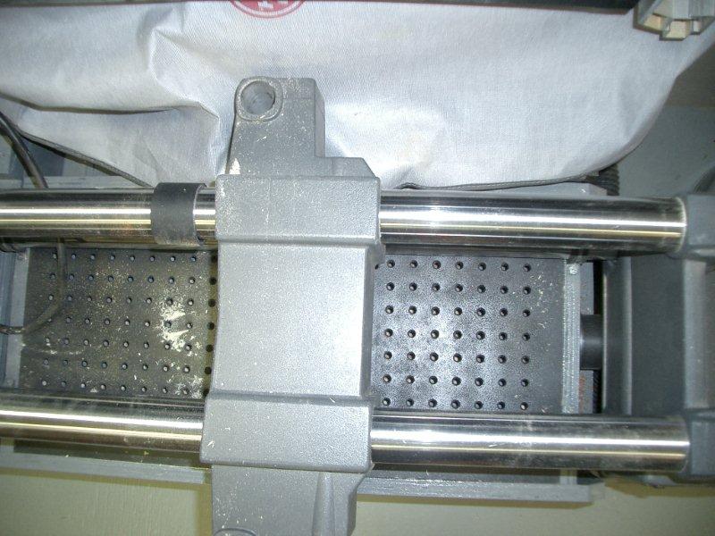

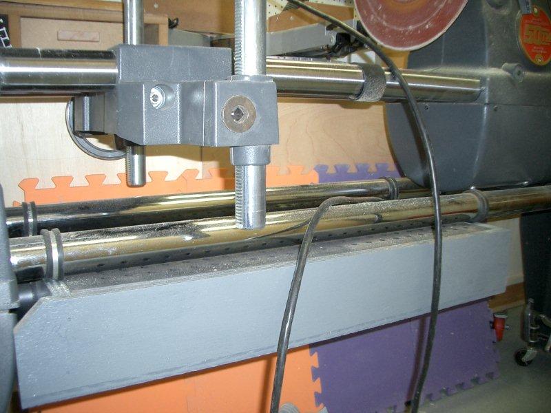

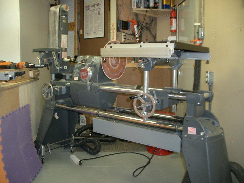

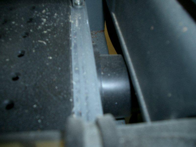

This downdraft box hangs below the way tubes and takes up the wasted space between the carriage table tubes. I only have a SS3300 dust collector, so it doesn't work perfect, but it helps keep the top of the cabinet cleaner.

What size are the holes in the top of the down draft box? I have a cabinet under my SS already, and I may incorporate a down draft.

Cory,
I love the idea of storing SPT and others accessories on the backside. I have been toying with the idea of under carriage storage for a few months and I had never considered the possibility of building up on the back.
One question, would the support of the upper back not be stronger if extended all the way down ? Seems the self holding the band saw would be a little top heavy. Perhaps there is support that I can't see.

The holes are 1/4 and chamfered. I don't know much about building downdrafts. Just guessed at 1/4 and thought I could always make them larger. It works OK for my small DC. Someone here probably has better info on the downdraft box.

Yes, it would be much stronger if the back extended all the way up. I didn't know when I built the bottom box, I'd have room to store all the SPT's up and behind. They were hanging on the wall behind the SS before.
I added the piece on with biscuits and used shelf brackets on the front side to make it strong enough.
