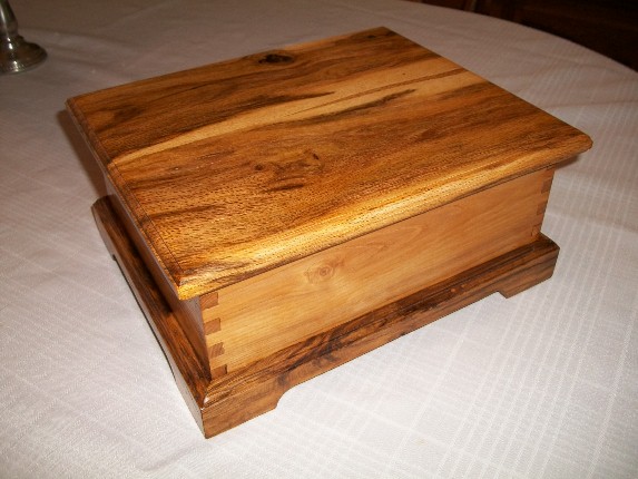

I have to try the pic thing
Ok, this might not be the best place to try this, but as long as the advise is fresh in my mind, I'll see if getting a pic in here works.
[ATTACH]15889[/ATTACH]
Cool, it worked. (it's a keepsake box I made for my grand daughter for Christmas. Oak (the top & base) and ash sides.

Nice jewelry box. She'll cherish it for life.trainguytom wrote:Ok, this might not be the best place to try this, but as long as the advise is fresh in my mind, I'll see if getting a pic in here works.
Now all I need to figure out is the link thing.
The link: depicted by the globe and paper clip. Click on it, fill in the url and click OK. The URL (the link) is now available in your post.
A lot easier than that jewelry box.
