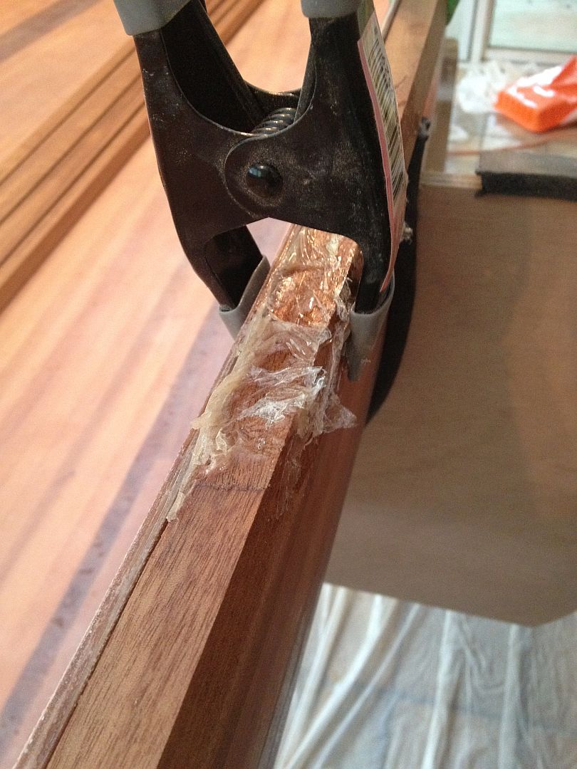

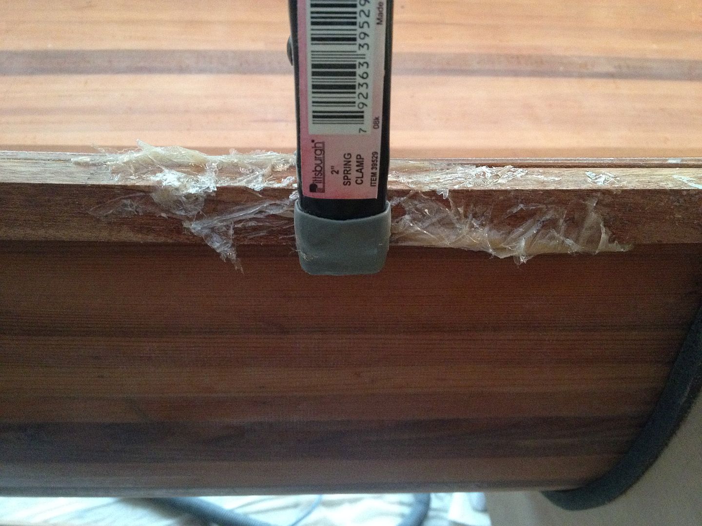

Well, I learned something.
I had the clever idea to put some Saran wrap under and over the scarf joint so the epoxy wouldn't get all over the piece of aluminum angle I was using to align and clamp the joint to.
Well, it protected the aluminum angle alright, but it created problems.
One, I couldn't get under and around the joint to clear off the excess epoxy (it was probably too runny -- another learning experience).
Then it melted and stuck to the Saran.
Here's a couple of photos of the mess (temporarily clamped to the canoe).
But, the joint seems like it is otherwise ok.
Now I need to decide whether to sand down the mess or, since I have extra length, just cut out the offending section and start over.
One thing is for sure, I need to devise a clamping jig that leaves the joint exposed on all sides so I can clean it up!
Re: A Slow Boat To Nowhere
Bench chisel to remove stuck/loose, then sand.
You WERE going to sand it anyway.
Worth a try. ;)
