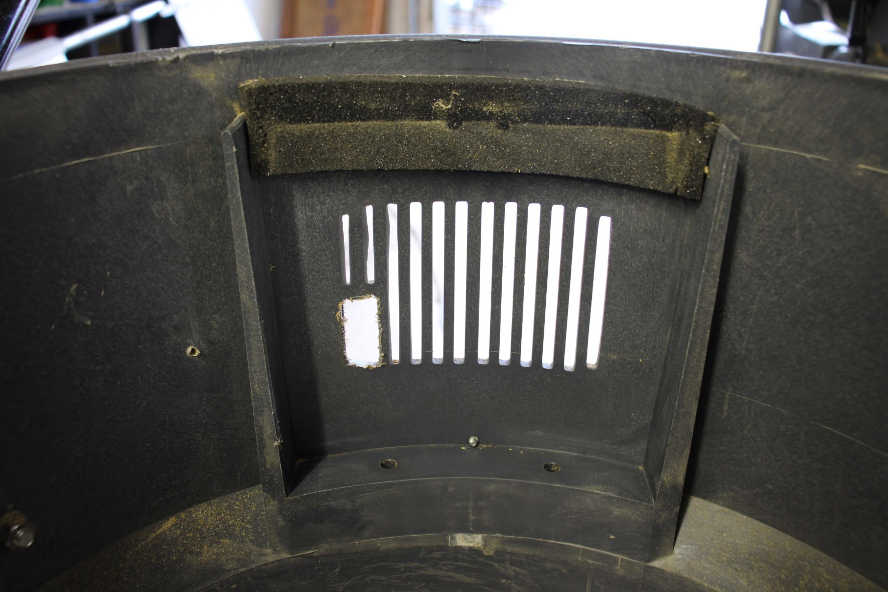

Con's: Most exasperating to me right now is mine leaks somewhere. I can see fine sawdust particles being emitted or redirected by the cooling fan, suggesting a leak between the main cavity and the motor housing. I'm not seeing any large pieces, only fine sawdust. I've mentioned the deteriorated seal at the top of the motor housing in another thread, but the upgrade came with a new seal. Further investigation is needed, but I am unimpressed by that fat foam seal trying to seal a fairly substantial gap.

I am dubious about that Shopsmith seal. It looks too porous to keep fine dust out of the motor.
In this thread, br549 used 1/8" x 2" self-adhesive rubber pipe seal. It looks like it has an impervious surface. viewtopic.php?p=234151#p234151

I've disassembled my DC-6000 Upgrade and see multiple issues that could cause the leak I'm chasing. I'd prefer one. (Zero would be good.) The first pic is the "U" in the main housing where the motor housing sits. Two major issues, possibly related but I don't think so. 1) Note the end of the screw protruding at the bottom. This is the end of one of the screws for the dust bag retaining clips. Mine is precisely located to prevent good seating of the motor housing in two directions, seating all the way down in the "U" and seating as far outboard as possible to reduce the size of that top gap. 2) Note the discoloration in what should be the clean side of the top 'seal.' IMO this is because the 'seal' is acting like a somewhat porous filter and has trapped some of the larger particles. The top part is clean because I vacuumed it before disassembly.

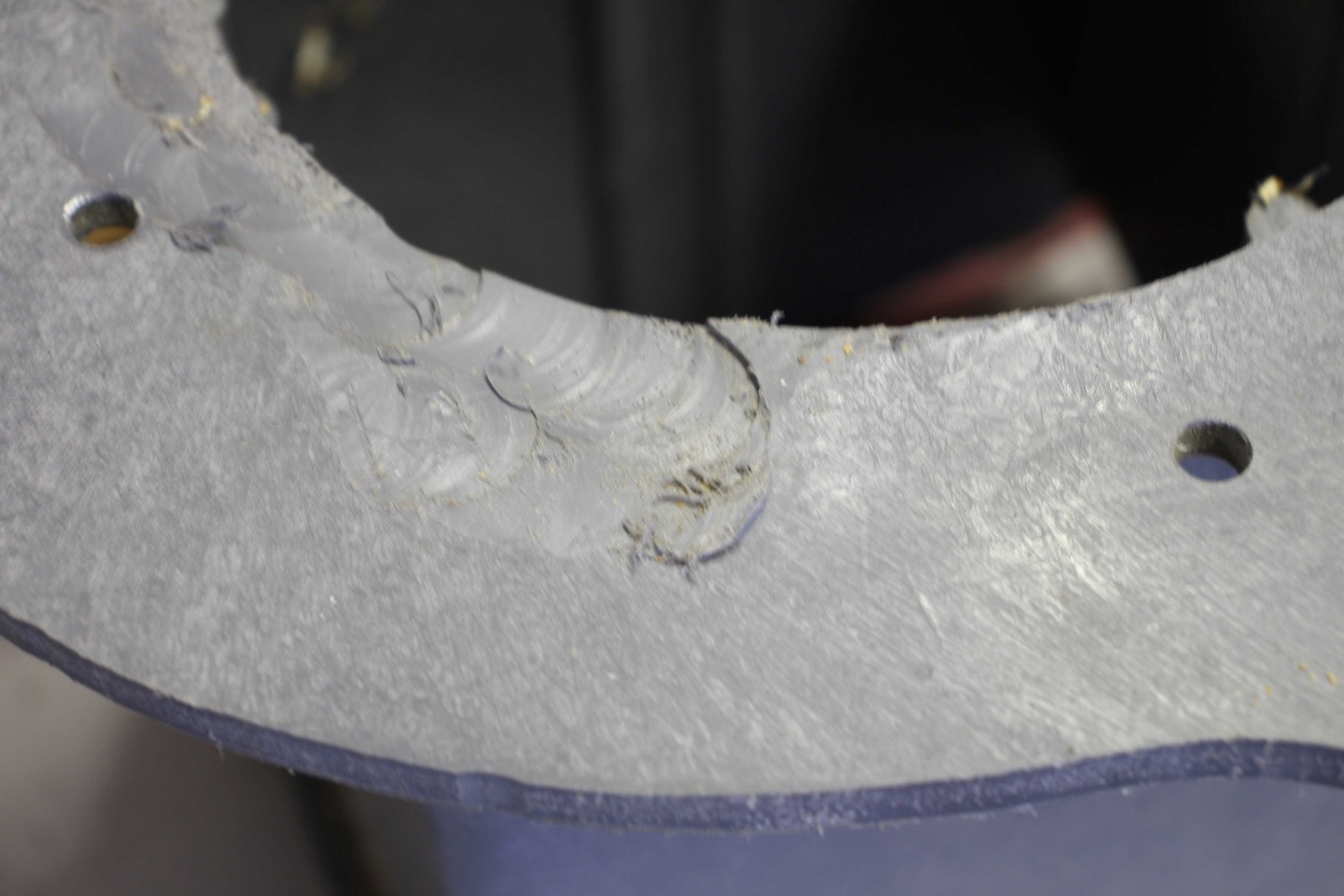

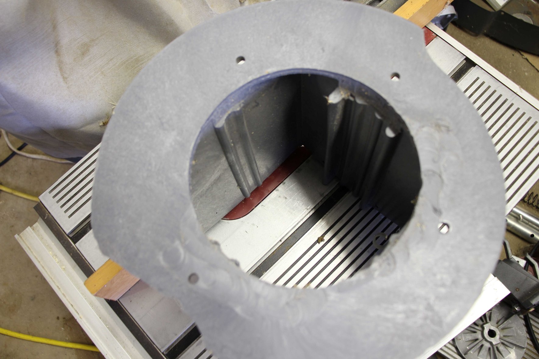

Next are two pics of the mating surface of the motor housing where it mates to the fan housing. (With apologies for the focus on the first.) There is no gasket or seal between the motor housing and the fan housing, though there is a rubber gasket between the motor itself and the fan housing. That might be okay if the surfaces of the motor and fan housings were flat where they mated, but as you can see they aren't. It looks like there was some kind of buildup on this surface that someone tried to clean up with a power tool, leaving both high and low spots. There is differential air pressure between the two volumes when the machine is running, so a leak here seems inevitable. The motor housing is held to the fan housing with four sheet metal screws, not particularly close together. The motor is through-bolted to the fan housing, so the motor housing is just a cover, unlike the DC-3300.

Is that how Shopsmith shipped you the new motor housing, i.e. with all those rough machining marks, etc.? Shouldn't it look like a new part, rather than a hack job? Let us know how Shopsmith responds on this one. Definitely disappointing to buy a new upgrade kit and receive something like that.

Yes, that is just as I received it. It shows evidence of quite a bit of machining for a plastic part IMO. I was looking at the last pic in this post earlier in this thread for reference: viewtopic.php?p=285499#p285499 and his has a different shape than mine. Which, again, just seems strange for a plastic part. That shaping is not in a critical area, but for example if you look at his you see areas where the motor housing protrudes out beyond the fan housing. Mine does not protrude anywhere. But both have that weird cutaway at the top that serves no obvious purpose, and on mine this was clearly machined after the part was formed. If you look at my closeup you can also see machine marks on the inside of the motor cavity. It makes no sense unless the mold allowed overflow that interfered with the motor. But the part I'm concerned with it looks like there was extra plastic formed proud to the mating surface . Someone cut most of it away but cut too deep, and did not get it all, leaving both highs and lows.
I'll see what SS has to say. The only think I've done is cut and ground that screw. And confirmed on another main housing that the protruding screw is "normal" or that another main housing is equally deficient.
