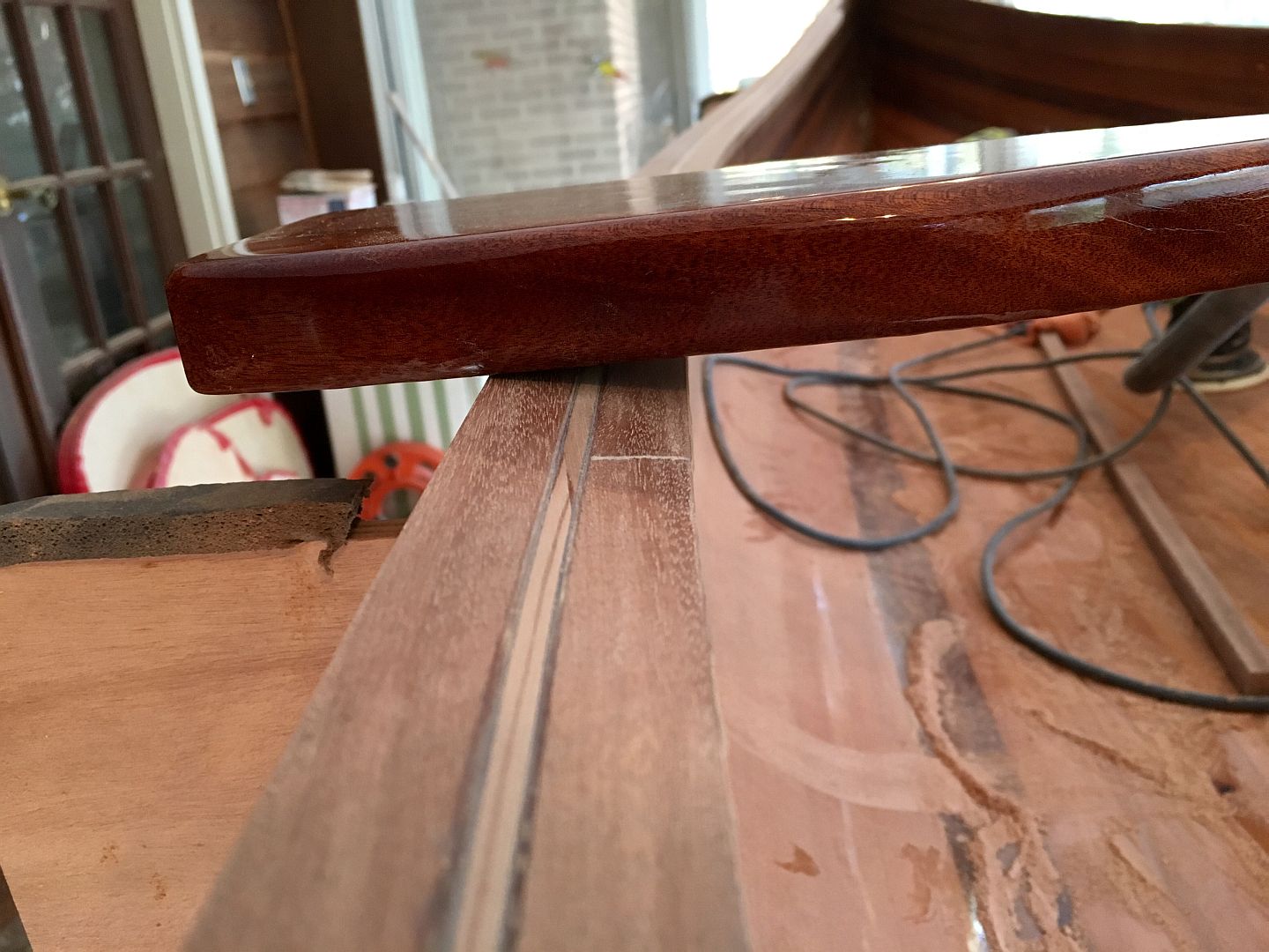

Anticipating a little challenge and soliciting advice. The canoe design I'm building has quite a bit of "tumblehome" in the middle of the canoe -- meaning in cross section the sides curve inwards at the top. This means the gunwales slope inwards from the outer gunwale to the inner gunwale.
It looks great; however, it creates a challenge for attaching the center thwart/yoke. The center thwart/yoke goes beneath the inner gunwales and is bolted through the gunwale. But, with the gunwales sloping if I do nothing to the thwart/yoke it will only make contact at the outer edge of the gunwale and there will be a large gap.
How do I measure the angle I need to cut out of the thwart/yoke so that it makes solid contact with the inner gunwale and how do I make that cut?
The photo shows the thwart resting on top of the gunwale but should give you an idea of the problem when the thwart is placed below.

Re: A Slow Boat To Nowhere
Slip a square piece (gunwale scrap) up under the gunwale and Mark the end of it with a stick in the place the thwart will go. That will give you the angle. Then I would just rip that piece (one each side) on the line just marked and glue (bed) it in place leaving you a flat mating surface for the thwart.
Easy peasy. :-)
Thanks, Paul. That sounds like the way to go!shipwright wrote:Slip a square piece (gunwale scrap) up under the gunwale and Mark the end of it with a stick in the place the thwart will go. That will give you the angle. Then I would just rip that piece (one each side) on the line just marked and glue (bed) it in place leaving you a flat mating surface for the thwart.
Easy peasy. :-)
