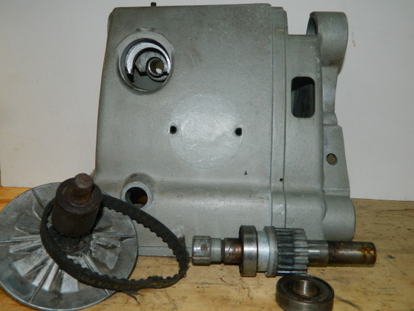

I've moved to the mechanicals, much more fun, here's the headstock stripped:
[ATTACH]17131[/ATTACH]
I used to think the rubber mallet was the best go to tool for taking things apart but in this project the heat gun was the hero. It's conquered five difficult tasks already- removing the quill and drive shaft being the most recent. Hail the conquering heroes:
[ATTACH]17132[/ATTACH]
I just about talked myself into cutting an access hole into this headstock. Usually I don't care to modify things but this is a maintence thing- it'll get lubed more often if its easy to do. Also plan to drill the oil holes for the sheeves. For the access hole I'm thinking to drill a pilot hole and use this hole cutter:
[ATTACH]17133[/ATTACH]
The idea is this will go in an old Rockwell radial arm drill press positioned close to a bench where I'll secure the headstock. I should be able to find the right angle to drill a pilot hole and then use this hole bit. Never used one of these for metal before. I have a set of these on hand and the 3 inch one has never been used. Feel free to talk me into or out of this plan, my finger's gettin ichy for the trigger though.
While I'm at it I'm thinking some other upgrades might be in order. I could go to the Poly v belt by robbing the other shopsmith- I'm not sure about this. Do I want to get away from the Gilmer? Also I'm thinking to go to a two bearing quill. Is anyone re-building these? I figure to take my old bearings to McGuire bearing here in Portland. I like to go local when the price is even halfway reasonable. I can do one headstock at a time, and for budgetary reasons pretty much have to. When I start adding up belts and bearings for two machines it starts to make sense to spread the cost out, especially at tax time. My techniques improves with practice also, so the second machine will go faster.
