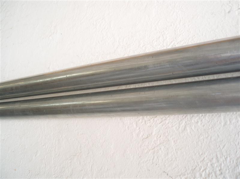

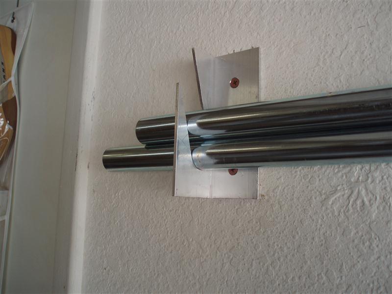

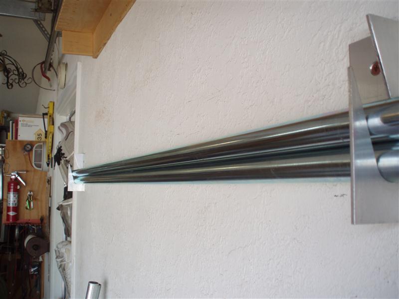

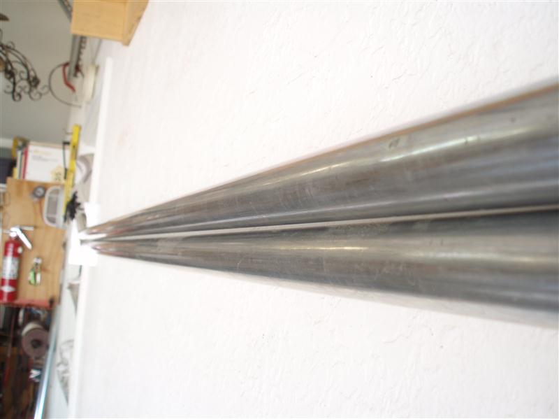

Yup, they are straight. Unless you are talking about my old tubes; they are not.
[ATTACH]18011[/ATTACH]
[ATTACH]18012[/ATTACH]
[ATTACH]18013[/ATTACH]
[ATTACH]18014[/ATTACH]
Can you determine which are new and which are old or which are straight and which are not?
I may need to alter the brackets that hold these tubes. They are scratching the tubes.

dusty wrote:Yup, they are straight. Unless you are talking about my old tubes]18011[/ATTACH]
Not from as cursory look at yer pix.
Surely you have not already forgotten Ed's string and two corks method!:p
first two pix are new and last two are old tubes. (maybe)
No, I have not forgotten. In fact I used it to ascertain that the old tubes were bent before I ordered the new ones. Good tip it was.JPG40504 wrote:Not from as cursory look at yer pix.
Indeed!!!!!!!!dusty wrote:No, I have not forgotten. In fact I used it to ascertain that the old tubes were bent before I ordered the new ones. Good tip it was.
