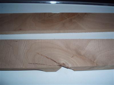

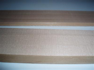

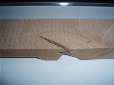

Resawing, Rough Cut
I got my new blade today and in comparison to what I have used in the past (for resawing), it cuts much, much better.
The resulting cuts are not smooth as glass but it certainly good enough for me to veneer without additional sanding (I think?).
[ATTACH]18529[/ATTACH]
Old Blade
[ATTACH]18530[/ATTACH]
New Blade
[ATTACH]18531[/ATTACH]
New Blade
To perform these cuts, I did NO drift testing and did not adjust the fence. It is set parallel to the edge of the blade. The rip fence is not absolutely square to the table top. I'll have to deal with that before I start cutting project pieces. I did not dress the back edge of the blade. I'll do that latere unless the instructions that came with the blade tell me otherwise.
This is a 1/2" Woodslicer 3 to 4 tpi from Highland Woodworking. The very first non Shopsmith Bandsaw blade that I have ever owned and only the third non Shopsmith saw blade I have owned.

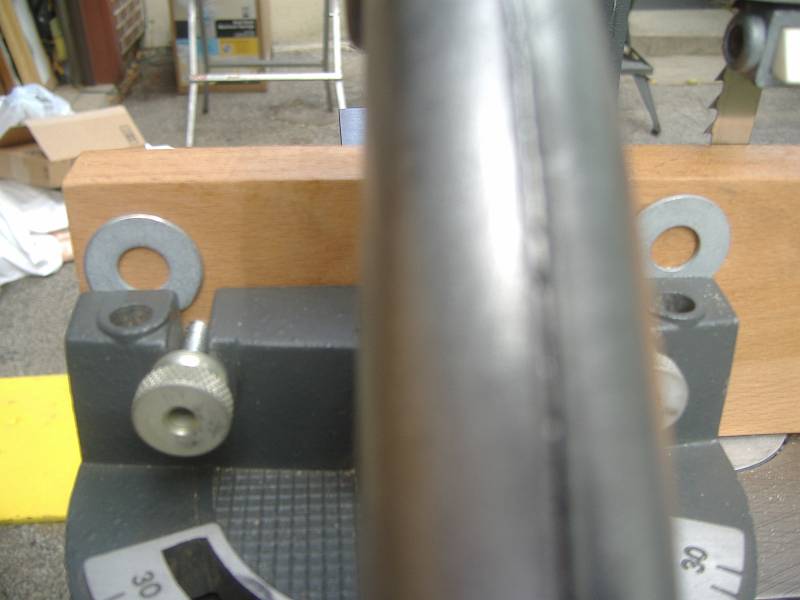

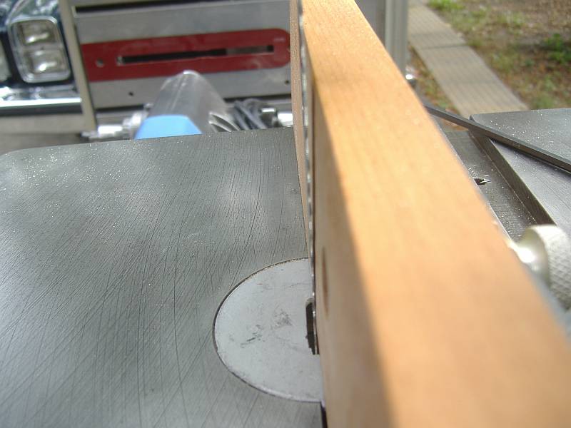

I did get to my re-sawing today. I set up with the miter gauge and found I need no additional adjusting. I cut a 1/16" slice off then halved that to make another pass. Worked as well as I hoped it would.
What I did find was the miter gauge from a ebay purchase may need to be looked at. I think someone may have removed a washer or put the wrong one in. The protractor head was not square to the table. The blade was touching at the bottom of the extension and by the time you got to the top the blade was more then a 1/16" away. The saw checked out from table to blade so it has to be the miter gauge or the extension. I didn't feel like working on that so I just shimmed it and got back to my project.
[ATTACH]18532[/ATTACH]
[ATTACH]18533[/ATTACH]
