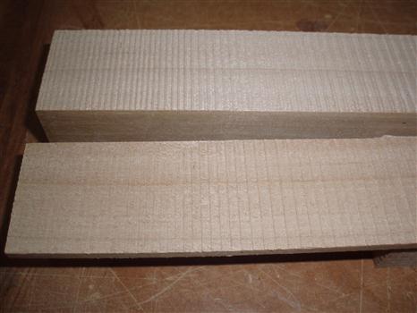

I don't do a lot of resawing and when I do it usually yields a piece that eventually goes through the surface planer.
Not the case for this project. I need some pieces cut thin enough that I can bend them and glue them together with other similar pieces. To do the laminate, I need a smooth gluing surface that I do not get from my resaw blade.
This brings me to my question. Should I expect a smoother surface than I am getting from this resaw blade.
[ATTACH]18477[/ATTACH]
- Resaw 002 (Custom).JPG (25.67 KiB) Viewed 3777 times
Dusty, I think you should get a smoother cut. All those bumps suggest you're pausing or the blade is moving about as you cut, which it shouldn't. Try feeding in one smooth motion. A straight fence to guide the wood and a featherboard to hold the stock against the fence will allow to cut in one continuous feed, and have a push block handy for the last few inches.
I don't know which blade you're using, but I would think that a 3/8 or 1/4 blade would be adequate for the width of the wood you're cutting.
You can use the drum sander and run the wood between it and the fence in drill press mode or between the drum and table to smooth out any irregularities, but take very light cuts.

pennview wrote:Dusty, I think you should get a smoother cut. All those bumps suggest you're pausing or the blade is moving about as you cut, which it shouldn't. Try feeding in one smooth motion. A straight fence to guide the wood and a featherboard to hold the stock against the fence will allow to cut in one continuous feed, and have a push block handy for the last few inches.

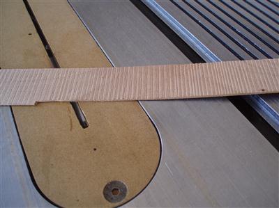

I did not use a feather board and I tried to maintain a constant feed rate. I know I paused once to reach for the push stick. The blade is 6 tpi and either 3/8" or 1/2". It is 1/2" from the back of the blade to the tip of the teeth (3/8" to the bottom of the gullet). It is a Shopsmith blade that I have had for a very long time but have hardly ever used. It surfaced a few weeks ago during a rummage session in the shed.
- Posts: 35598
A bent section or errant tooth on the blade?
What does the other 'half' look like?
Is it a mirror image, or identical?

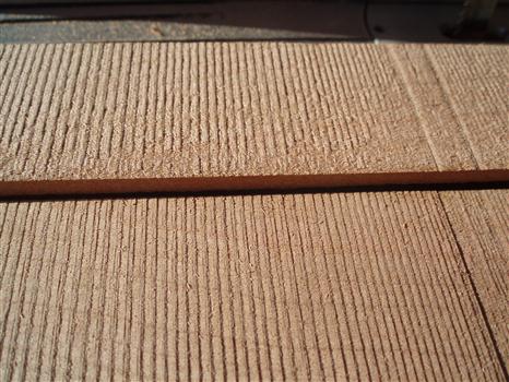

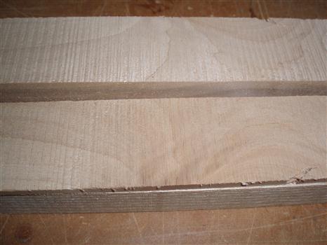

The cuts that Doug got from the PowerPro/Bandsaw setup were certainly smoother than what I am getting.
Unfortunately, I am currently dependent on my simple, twenty year old Mark V.
This does show though that this cut can be done with much smoother resulting surfaces than I am getting. I guess it is time to invest in a new resaw blade.
Under normal circumstances, I would be satisfied with this. It is only because I am going to laminate the pieces in a curve that I want smoother surfaces. Yes, I can sand them smooth but I was hoping they would come off the bandsaw smoother than this.
These are the facing cuts you ask for JPG.
[ATTACH]18483[/ATTACH], [ATTACH]18484[/ATTACH]
I used a feather oard for this cut and I maintained a near constant feed rate the entire length.
When it gets light, I'll make a couple more cuts at a slower feed rate but I don't expect a big difference. I'll also do a drift test. The fence is set square to the table (parallel to the blade) now.

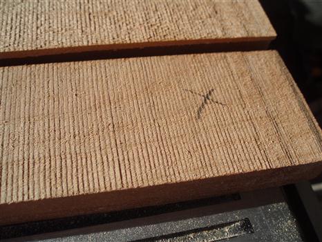

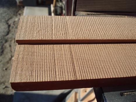

OKAY. Last self imposed test cut. The fence has been adjusted for drift, the feather board is in place, speed is at 900 rpm, blade tension has been verified (no change).
[ATTACH]18486[/ATTACH]
[ATTACH]18487[/ATTACH]
[ATTACH]18488[/ATTACH]
The only thing that I know to do is buy a new blade or get ready to sand a lot.

JPG: These shots should answer your question regarding a "mirror image". No, not exactly a mirror but there is some "reflection".
- Still More Resawing 001 (Custom).JPG (40.31 KiB) Viewed 3701 times
- Still More Resawing 002 (Custom).JPG (50.74 KiB) Viewed 3700 times
- Still More Resawing 003 (Custom).JPG (44.78 KiB) Viewed 3697 times
- Posts: 35598
I think the blade is 'wobbling' or 'twisted'.
Manually rotate the wheel and observe the positioning of the edge of the blade against a straight edge(combination square head). I am guessing the blade oscillates in/out(sideways to blade travel).
