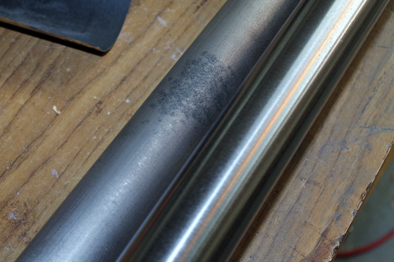

One bench tube down, one to go. The tube on the left was after electrolysis and a scotchbrite pad to clean off residual funk. The spot of pitting in the picture is just about the only pitting I've found so far (knock wood).

Jonathan running some 150 grit on the second tube. He really enjoyed being able to put his hands on something spinning like that; touching something I'd normally tell him to keep away from for safety. For the first tube the setup was actually reversed, with the drill anchored on my tablesaw and the guide rollers on my work table. The results were pretty bouncy and I reversed it to try and calm the tube down. Let me tell you, 300 pounds of table really calms things down so anchor it and stack whatever you need to keep it smooth. I'd also recommend getting larger wheels, preferably urethane and 3-4", because the plastic 2" ones I had have a seam on them and that translated to the tubes. You can sand them some but if you know ahead of time you can avoid it.

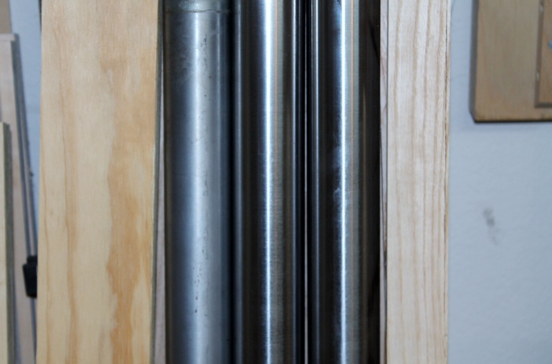

Two finished tubes inside and out. The way tubes, one on the left, were not rusted at all on the outside. There are some blemishes and black marks but the thing that is odd to me is that the grain (?) on these tubes appears different than what I got on the bench tubes. I'm not sure if that is a trick of my eyes but I'm trying to decide what to sand these to. Bench tubes went to 400 and while that texture doesn't seem as smooth as the way tubes currently are I think it would be great. Maybe someone will have some insight one way or another.

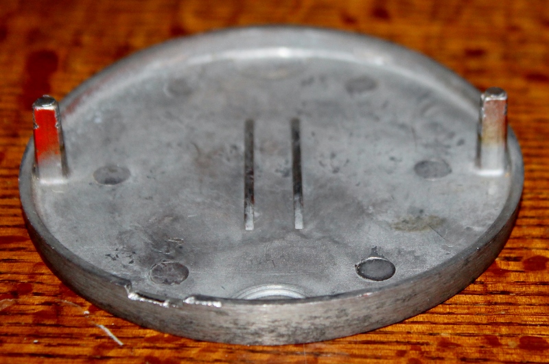

Here's the badge from the back of my headstock. No access hole but I'm fairly certain that badge was built to receive a spring or whatever it's called between those two vertical lines. I haven't seen a close up picture or handled one but assuming that is correct I should be able to carefully drill out between the holes for the prongs and once I find a spring I should be able to simply mount that and install it. Any sources for a spring? I didn't see one on Shopsmith with a quick search.

The bench and way tubes are indeed different steels. I believe that is one reason the bench tubes were originally painted.
The logo/medallion did not originally have a retaining spring between those two ridges, and the posts were inserted in the two holes in the casting, and a retaining clip slipped over the posts from the interior.
Those ridges are however a precurser to the later design. The posts were made round and a spring was indeed swagged between them. That design held forth for almost a half century.
So if you intend to cut an access hole, that version is often found on e-bay.

So is there a separate process that people have gone through for the wag tubes? My searches say no so I was just expecting to take them to 400 grit as well.
Is it possible to purchase just the clip and JBWeld it to my medallion? Or to manufacture a clip on my own? Maybe more trouble than it's worth but both that medallion and original speed control handle are still usable so I'm trying to keep both in service and unaltered as much as possible. As you mentioned above the clip design lasted for nearly 50 years so it's certainly functional.

pds0006 wrote:So is there a separate process that people have gone through for the wag tubes? My searches say no so I was just expecting to take them to 400 grit as well.

Bench/way, same procedure except removal of 'surviving' paint on bench tubes. Electrolysis will remove the paint.

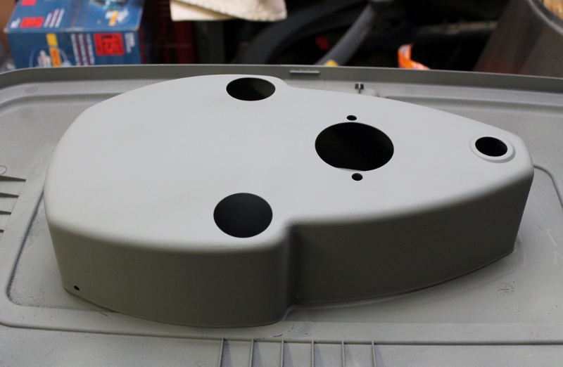

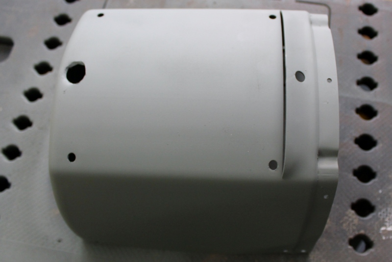

Haven't had a lot of time since my last post so not a great deal of progress. But something of a milestone as I've put on the primer for the motor pan and the belt cover.
[ATTACH]24430[/ATTACH]
[ATTACH]24431[/ATTACH]

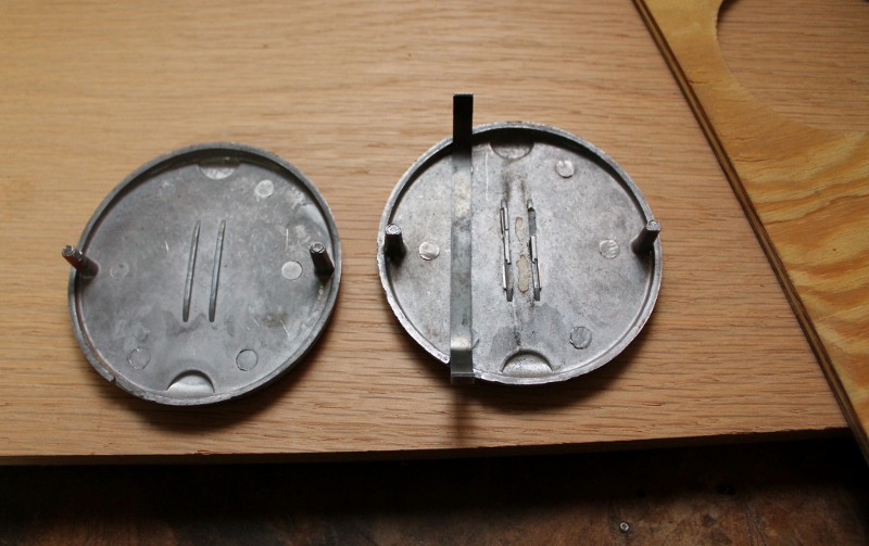

On the left is the original badge for my SS and the replacement I bought on the right. I have a 3" bi-metal hole saw and tried it on a piece of 1/4" plywood (visible upper right) to see what the fit was like. The badge went on fine but while trying to pry it off the spring separated as you can see. Not sure if the swaging was weak, the hole was too small, or both. If the swaging is weak I assume some JB Weld would fix it but I can't tell if there's something to do to the swaging to prevent this.

It looks like someone else has already tried to 'glue' it back on.pds0006 wrote:Haven't had a lot of time since my last post so not a great deal of progress. But something of a milestone as I've put on the primer for the motor pan and the belt cover.

The spring is designed to grasp the thin headstock casting. I presume the 1/4" plywood was over stressing the spring(and swage).
