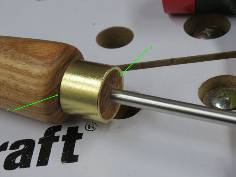

Guess who wasn't paying enough attention to what he was doing today. I'm guessing that would cover a lot of us but in this case it was me.

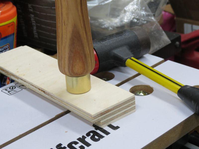

Here is a picture where it shows how I put the ferrule on. I have a scrap of plywood that I drilled a 1/4" hole in. I put the ferrule on the lathe tool and then the blade goes in the hole. By tapping on the wood handle the ferrule goes on, or at least it should.

Today I tapped it on, and yes it is a tight fit, only to notice that the ferrule is not going all the way on.
This next picture shows what happened. The less then 1/16" space between the handle and the ferule seating is shown by the "A". Why did this happen? Well look at "B", the ferrule is flat with the wood and it is not going to go any anywhere any more.
[ATTACH]24620[/ATTACH]
Searched the shop for something the same size of the ferrule and found nothing......... so I'm going to have to order another ferrule and tape the two of them together so I can get that last bit of movement that I need.
Of course if I had checked after taking the handle off the lathe I would have seen that and cut just a bit more off. Well that didn't happen today.
Just something to remember to check as you finish up a project.....

What material is the ferrule made of. If it's brass, you could have trimmed it while it was on the lathe.
It is already too short for the handle!beeg wrote:Ed

I'm more accustomed to dealing with taper-lock bushings (tapered shaft clamps, really) in all-metal assemblies. Wood is much more compressible, so take this with a grain of salt. But the linear travel of a taper bushing should be stopped by the radial force of the clamping action upon the taper, and nothing else. If you bottom out on anything else, you have not achieved the full clamping force.
Ergo, I agree that you do not want to be stopped by your assembly jig when the ferrule becomes flush with the end of the handle. But if you want maximum clamping force, you don't want to bottom out against the shoulder of the handle either. Plus, you may need some extra room to tighten the ferrule in the future, should the wood shrink a bit. That's my theory, anyway.
I doubt the handle is tapered!:rolleyes:BuckeyeDennis wrote:I'm more accustomed to dealing with taper-lock bushings (tapered shaft clamps, really) in all-metal assemblies. Wood is much more compressible, so take this with a grain of salt. But the linear travel of a taper bushing should be stopped by the radial force of the clamping action upon the taper, and nothing else. If you bottom out on anything else, you have not achieved the full clamping force.
