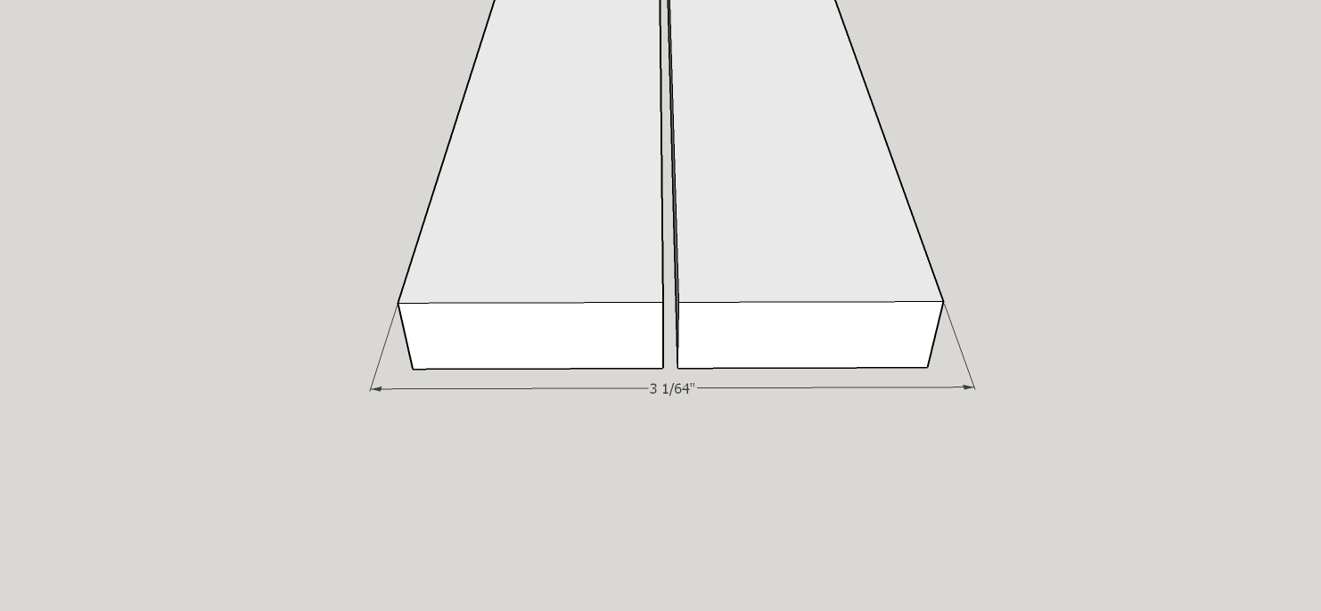

I have been grossly over thinking this Main Table Alignment Tool. In reality, two pieces of wood cut to the correct width is all that is required.
Once you have the two pieces of wood (get them to the correct dimension any way you know how), you are ready for a quick and dirty alignment.
Get the Mark into saw mode. Loosen all four trunnion bolts, remove the table insert and drop the table down as far as it will go without altering the horizontal position.
Insert one of the two freshly milled pieces on the left side of the blade where the table insert would be. Now insert the other on the right side of the blade. The table has now positioned itself so that the miter slots are parallel to the blade and the blade is in the center of the cutout.
Tighten the trunnion bolts and you are done.

Re: My Newest Toy
dusty wrote:I have been grossly over thinking this Main Table Alignment Tool. In reality, two pieces of wood cut to the correct width is all that is required.
That is indeed quick & slick! But first, I'd measure the sides of the table-insert slot, to verify they are precisely parallel to the miter slots.
"precisely parallel" - you do mean "precisely as in wood working" right.
The quickest way to do that is to rip a piece of scrap to the width of your table insert (I think all the Shopsmith inserts are 3") and see how it fits. They are not all precisely the same size. I have four tables and there is some deviation in width but my home made table inserts fit in all of them.
When I make table inserts, I cut them initially oversize and sand for a snug fit. I consider the table cutout to be 3 1/64" wide.
