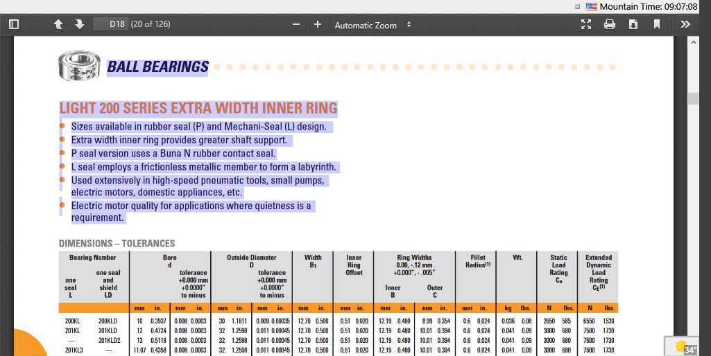

JPG wrote:'Extra' width is likely a problem. I believe it needs to be 15mm.
The 200 series Fafnir bearings of which we speak all have an extra wide inner race. It is not much however.
Check page D18 in the Timken catalog.
https://www.timken.com/wp-content/uploa ... atalog.pdf
Timken Catalog.jpg (84.29 KiB) Viewed 16308 times

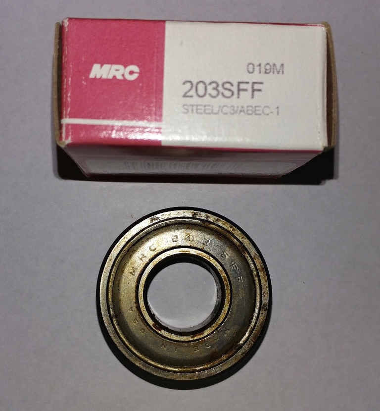

Everett has not fully explained it yet and it needs to be clarified. There are two different specifications. C3 refers to the internal bearing clearance of the races and the balls. When Everett says C1 what he actually means is ABEC1 which is a tolerance specification of all the parts of the bearing. Think, the outer race diameter is 1" +- .001 as an example. The ABEC1 specification makes the original Fafnir bearing in the 10ER a precision bearing.
The original 10E was built with precision bearings according to printed documentation. The Fafnir bearings specified in the 10E/ER documentation (205KLL2 & 202KLL3) are in fact ABEC1 which makes them a precision bearing. However, their internal clearance is C3. To be called a precision bearing the bearing must conform as a minimum to the ABEC1 specification.
Yes it is confusing because a lot of people don't understand the difference.
The picture is of the bearings in an A.O. Smith 1/2HP motor from a 10ER. The bearing is the original I removes from the motor. The box is from the exact replacement new bearing. Notice the box says C3/ABEC1. That makes it a precision bearing with a C3 internal clearance.

No, I want a number that identifies a product, when looked up on a search, to return results for that same product everywhere. I wasn't speaking about price as much as I was speaking about not really knowing what bearing you'd get if you were to order the bearing by number. Apparently the clearance code is not part of the part number, so you have to specify it. If you read Everett's document on it it almost sounds like a bearing supplier conspiracy to pass the cheaper ones off as matches for tighter clearance ones. We're talking all Fafnir bearings here, but apparently middlemen that can't be trusted.
So if I ordered them by Fafnir part number, and the supplier's computer says they are C3 internal clearance, they are a match to the original? Maybe I shouldn't have been nervous about them selling me the wrong thing. I went in with page 2 printed from that document not knowing what I was asking for.
