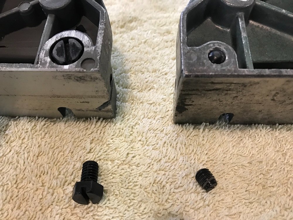

As for the Miter it looks like the previous owner made some bevel cuts and removed the table insert for the blade to clear instead of extending the quill. Always use the Miter to the right of the blade for bevel cuts. The miter for my 520 has a single small cut in it that my father-in-law did by not following that rule. See the miter on the left below. I have had several Model 10's with cuts in their miters too. I have found most can be repaired with JB Weld to fill the cut and after repainting is hardly noticeable. Yours look a little to far gone to repair.
Miter Glides.jpg (162.23 KiB) Viewed 1661 times

Thanks Russ, I think you're right and I will be looking for a replacement miter gauge. I checked and the nylon glide was sheared off on that side.
