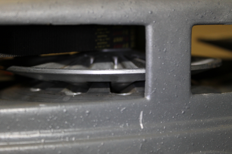

Belt is off, went around the inside toward the porkchop and out through the belt cover down past the floating sheave.
Neither the floating nor the control sheaves are moving (sliding ) at this point. I too suspect they are both stuck and needing some sort of break free juice. What flavor break free juice do you guys recommend?
The belt removal over the control sheave was very easy and only took 2 very small screwdrivers and maybe 2 minutes time (evaluate/obtain tools/execute).

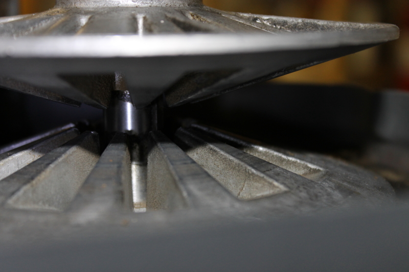

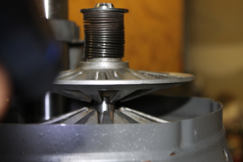

Here's a few shots with the belt off.
Control/Idler sheaves position post belt removal
[ATTACH]16237[/ATTACH]
Floating Sheave position post belt removal
[ATTACH]16238[/ATTACH]
Floating Sheave position post belt removal #2 This also has the Key way visible too. The shaft the key way is on was/is very dirty. Could this be partly due to my recent oiling like heck?
[ATTACH]16239[/ATTACH]

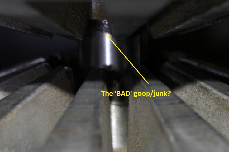

Is the spring compressed or are you using something to hold the sheaves open? I see some corrosion or some other contamination on the motor shaft between the vanes of the floating sheave. It looks like that is what be preventing the sheaves from moving. Kroil Oil or PB blaster that has been recommended is the way to go. Be gentle with the sheaves they are easily damaged. The spring is going to be a B---H to remove while it is compressed as well as dangerous. There is a tool described in some SS literature that can be made to restrain the spring safely. When I work on a headstock I remove the spring from the shaft and run the motor and polish the shaft with some 3 in One oil and 600 grit wet or dry sandpaper. The black stuff may also be oxidized oil. A thorough cleaning is definitely called for.

I assume your referring to this black crud on the shaft... I've gotten most of it off using some cotton swabs and gun cleaner. It's an amazingly dirty area...
[ATTACH]16245[/ATTACH]
When I spray it down with the PB Blaster, I assume I should lower the way tubes and headstock back down from the drilling position so as to not drip/run the penetrating oil down into the motor assy?
For the control/idler sheaves, I can't see the shaft but I assume it's also got that same black gunk on them as well.

Hurray! Now we can 'see' the 'problem'. The motor pulley usually sticks at the other end. It has got to be easier to push( with the spring helping) than trying to pull it out. Any force needs to be applied near the center(hub). Some penetrant applied through the spring to the shaft off the end of the sheave should help. I gotta know what was applied prior to storage. 3 in 1 by itself would not do this (at least I do not think so). It must have dissolved the crud and then it hardened.
The idler shaft pix still has the belt in there!
Both movable sheaves need to be soaked from the end previously obscured by the belt and allowed to seep. Do not apply so much that it will drip into the motor, but the fan sheave should prevent very much from getting that far. Coating the outside will do little good, the sheave bore/shaft/keyway are the areas needing 'solvent'.

OK I've given her several spritz's with PB Blaster (from bLowes). I have extra spray straws so I used one to try and get the PB Blaster into the inner portion of the Control/idler sheaves. I'll spritz it again tomorrow AM.
To date I've only used 3 in One oil on this unit. The previous owner I have no idea what they used as I bought it from a guy who picked up a storage unit on an auction.
If the PB Blaster works on the floating sheave, I guess there's a possibility it will suddenly close under the spring tension alone. I'm working to keep my fingers out of the way...

I seriously doubt anything will move without 'coercion'!jtrainer wrote:OK I've given her several spritz's with PB Blaster (from bLowes). I have extra spray straws so I used one to try and get the PB Blaster into the inner portion of the Control/idler sheaves. I'll spritz it again tomorrow AM.
Once you get them moving and then cleaned up and oiled. you will be amazed at how easily they will then move.
Tis far easier to keep them oiled than what you have been doing!;)
