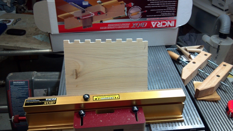

It took me over 2 hours to figure out how to get around that mounting screw head before I finally gave up and found it doesn't really make any difference. Here is my very first attempt at using my 6 inch stacked dado to cut some box joints. I think I'm ready for the big time. I'm going to build a box for all my scrap wood.
