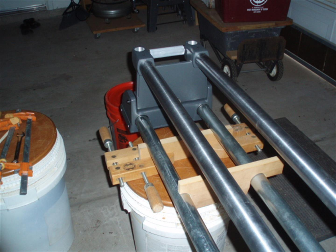

I received the Double Tilt Kit today and began assembly. I will not be going much further than I am right now UNTIL I have had a chance to verify measurements. At this point I know that the Way Tubes are dead on with respect to one another. I also know that the Bench Tubes are NOT. This may be an assembly error but I am inclined to say that the dimensions of the new castings is just a tad different. Time will tell.
I am posting a picture so that ER won't have a reason to doubt the Double Tilt. It doesn't show much except that there some parts of a double tilt in my garage shop.
Double Tilt 1st Inspection 004 (Large).JPG (742.99 KiB) Viewed 2039 times

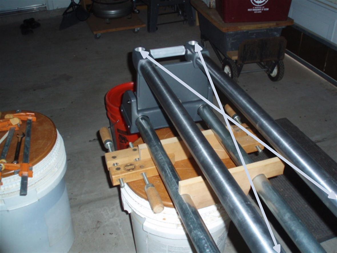

I'd like to know how the diagonal measurements come in, a test of squareness of the parts. You know like this:

reible wrote:I'd like to know how the diagonal measurements come in, a test of squareness of the parts. You know like this:
They measure just a hair off of 53 5/8". One diagonal is a tad long and the other short.
If you read this before this edit occurred, ignore (at least for now) what you read. I have made changes.
The diagonals now read 53 3/8" and they are the same. This will be a challenge to maintain because each time you take off a Pivot Arm there will be an opportunity for it to change. That would not be an issue IF the Pivot Arms bottomed out on the Way Tubes but they do not. I am really thinking spacers in the Way Tube holes to eliminate this.
I altered the separation between Pivot Arms as measured on the Way Tubes. I now have exactly 48" of Way Tube exposed between the Pivot Arms. This is a good number (if I don't have to make changes later) because it will be easy for me to remember. Whenever I have had the Pivot Arm removed, I will know where to locate it when I put it back on. I also now need to locate (or make) some split lock collars that fit the Way Tubes.
The Pivot Arms now fit snugly between the Pivot points which measure an exact 50" (inside to inside) between the two ends.
A Datum Addendum: With the Bench Tubes and Base Units inverted (bottom side up) I measure 48 1/16" of exposed Bench Tubes between the two Bases. I would bet, based on all my experience measuring various parts and clearances on the Shopsmith, that the specification for this is 48". I could easily make it 48" by filing a little bit off of the 'stop rib' in one of the Bases but I am not going to do that.
Also, while the undersides were exposed, I loosened the hold down bolts at one end of the Bench Tubes and applied a little downward pressure. Doing this eliminated all of the diagonal rocking that I had experienced. With that done, I believe I an through with the Bench Tubes and Base Assemblies. It is now time to remount the legs and put her back on her own feet.

I have done nothing extra ordinary as I put this back together. I am thankful that I torn it down as I did. I did that to reduce the weight of any one item that I had to move around. I pulled the carriage and table, I dropped the motor pan, I removed the headstock and then, with what was left sitting atop barrels, I removed the legs. At this point, the only thing sitting there that was going to remain was the tubes.
This probably all took me a bit longer but it was fun and I didn't strain anything.
As for measuring with everything installed, consider sliding it all to one end, mark the tubes and then slide everything to the other end.
Speaking of measurements, mine have changed from what I posted. I was unable to retain the exact 48" between castings. To get the Pivot Arms to properly engage, I had to change the locations. The separation between Pivot Arms (on the Way Tubes) is now 48 1/8". That will change the diagonals too but as you said, Ed, with everything mounted there is no way to measure those now. Suffice it to say that the Way Tubes in conjunction with the Pivot Arms form a precise rectangle.
