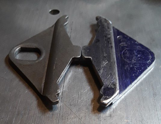

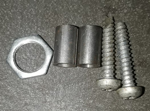

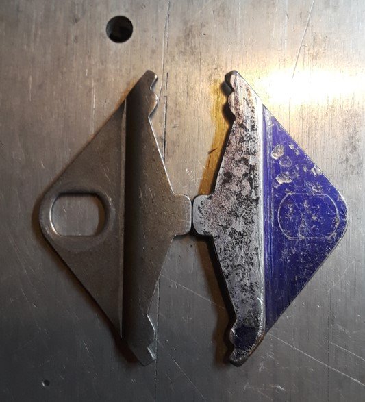

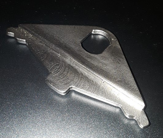

Mike, I think I got you covered for this part. It will be very difficult to fabricate if you don't already have one to use as a template. I imagine finding one sold separately is nearly impossible? It also has a 3/16" (overall) offset bent into the plate that I can't bend, but I should be able to machine the offset. I'm going to give it shot. You're going to need the parts in the bottom two pictures, 2- thin nuts (one for the lock bezel, one to attach the interlock plate), the spacers, and the screws. I can provide dimensions when needed.Mike wrote: Sat Sep 10, 2022 10:53 pmWell no, he doesn’t have that part but I’m 80% there so will keep looking. Worse case I’ll try and make one. This has proved to be a much more difficult adventure than I anticipated but I’m retired so I have time to look around. ThanksJPG wrote: Wed Sep 07, 2022 11:13 pm The parts that attach to the lock that provide interlocking of the switch between fwd and rev.

80% done means we need some progress pics.

Mike that would be most excellent if you could accomplish that mechanical miracle:-) of course we need to work something out on it for payment because… well just because:-)miken wrote: Sun Sep 11, 2022 12:10 pmMike, I think I got you covered for this part. It will be very difficult to fabricate if you don't already have one to use as a template. I imagine finding one sold separately is nearly impossible? It also has a 3/16" (overall) offset bent into the plate that I can't bend, but I should be able to machine the offset. I'm going to give it shot. You're going to need the parts in the bottom two pictures, 2- thin nuts (one for the lock bezel, one to attach the interlock plate), the spacers, and the screws. I can provide dimensions when needed.Mike wrote: Sat Sep 10, 2022 10:53 pmWell no, he doesn’t have that part but I’m 80% there so will keep looking. Worse case I’ll try and make one. This has proved to be a much more difficult adventure than I anticipated but I’m retired so I have time to look around. ThanksJPG wrote: Wed Sep 07, 2022 11:13 pm The parts that attach to the lock that provide interlocking of the switch between fwd and rev.

Thanks JPG, yes, the only real milling on this was splitting the steel in half two ways to create the offset, and the slotted hole. The rest was good ol' fashioned hack saw and files. Thanks for noticing.JPG wrote: Mon Sep 12, 2022 11:42 am . . . MIKEN thee does good work with a ''German" Milling Machine* . . . * file

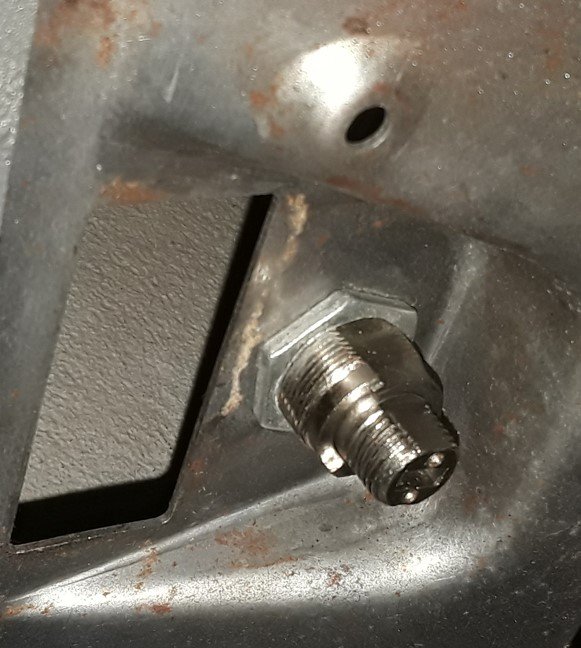

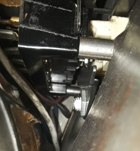

Well, you can cross the interlock plate off the list. Done and fit tested. Works.Mike wrote: Mon Sep 12, 2022 4:10 pm . . . No key, was gonna file down something and maybe see if it will work. I knew this key set up and all the awkward wiring were gonna be the biggest head ache for sure. So slow and steady, steady and slow be the way I go...
Hard to see in the picture, but it's in there and functions properly. As for the key, I have two machines with two different keys. Can't help you there, but maybe a locksmith can make you a key?
- Interlock1.jpg (70.1 KiB) Viewed 1877 times
- Interlock2.jpg (52.25 KiB) Viewed 1877 times
