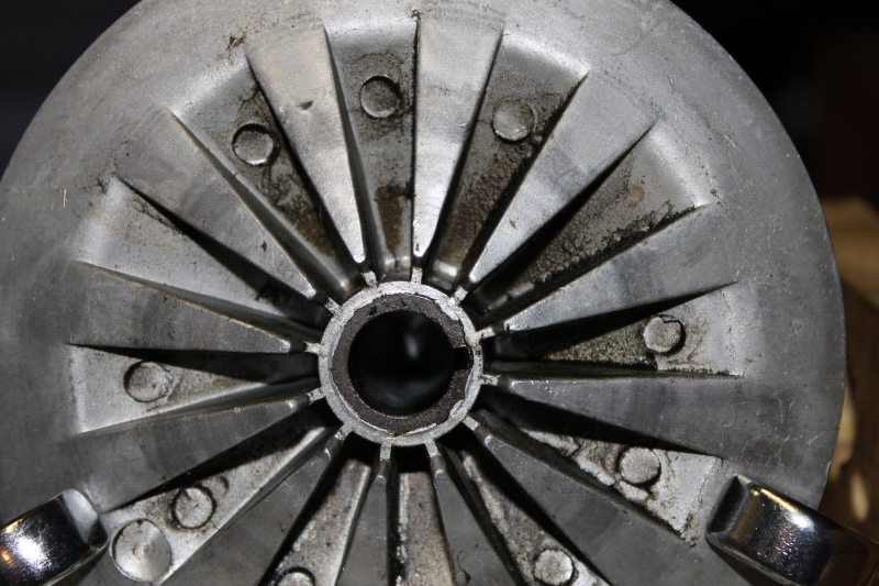

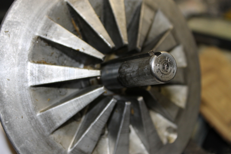

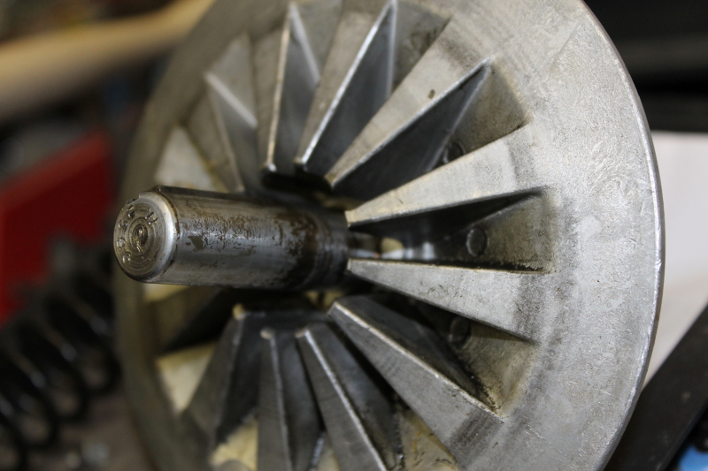

OK I decided to get mid-evil on it...
I had a few 1 foot 2x4's that were glued and screwed some time back. I drilled a hole through them, placed over the floating spring and used another board on top of that and hit it about 20-25 times. and viola the Floating Sheave is now inward flush towards the Fan Sheave.
Now playing with the spring tension I can see it will be stiff but not impossible to move, however the sheave will not move back outward under my manual strength (YET). This is a good start and the spring tension is greatly reduced now.
Floating Sheave side A
[ATTACH]16257[/ATTACH]
Floating Sheave side B
[ATTACH]16258[/ATTACH]
Control Sheave
[ATTACH]16259[/ATTACH]
I guess I'll attempt to get the idler shaft out next....
EDIT: I have those clamps, that's a great idea on how to compress the spring.
Control Sheave

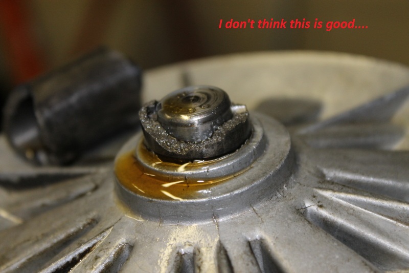

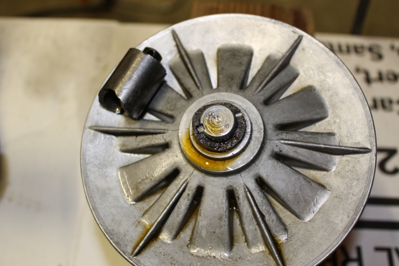

SIGH!

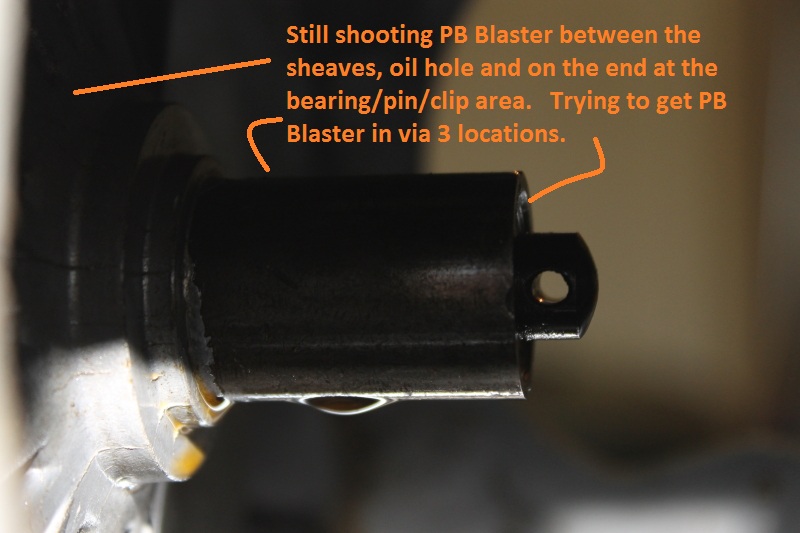

Idler is out, motor is down.... Control Sheave is/was moving outward. I was using a technique I read here by making several wedges. Perhaps I needed more PB Blaster... Anyhow the Control Sheave slipped from my vise jaws which was protected by some pine and leather.
Anyhow it slipped and fell to the ground and well take a look below.
[ATTACH]16269[/ATTACH]
[ATTACH]16267[/ATTACH]
[ATTACH]16268[/ATTACH]
Is the Idler shaft salvageable still?
I know the control Sheave needs to be replaced.
Sort of afraid to start on the floating sheave now...

jtrainer wrote:SIGH!![]()
Anyhow it slipped and fell to the ground and well take a look below.![]()

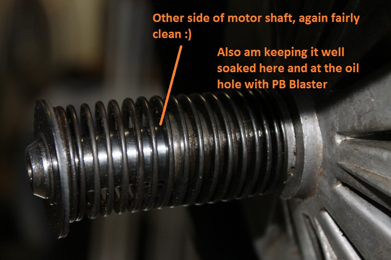

Now that the end of the idler shaft is accessible, a gear/bearing puller will work. You have also been relieved of the need to worry about damaging the control sheave.
Yes the control sheave is scrap. Save the button/bearing/clip.
The spring needs to now be removed from the motor shaft. I assume you now know how with the clamps. A pair of snap ring pliers will be quite useful!
Now that the floating sheave has become unseized, removal of spring tension will make removal easier. I am sure there is crud on the shaft towards the motor end. It needs to go bye bye! Prying on the sheave near/at the hub will keep it from cocking/getting damaged.
Do not try to bounce the floating sheave on the floor!;)
The idler shaft will be cruddy also.
Hard for you to realize that you have made progress, but getting these seized sheaves moving can be a real trial.
Reassembly will be a 'snap' compared what you have been through!

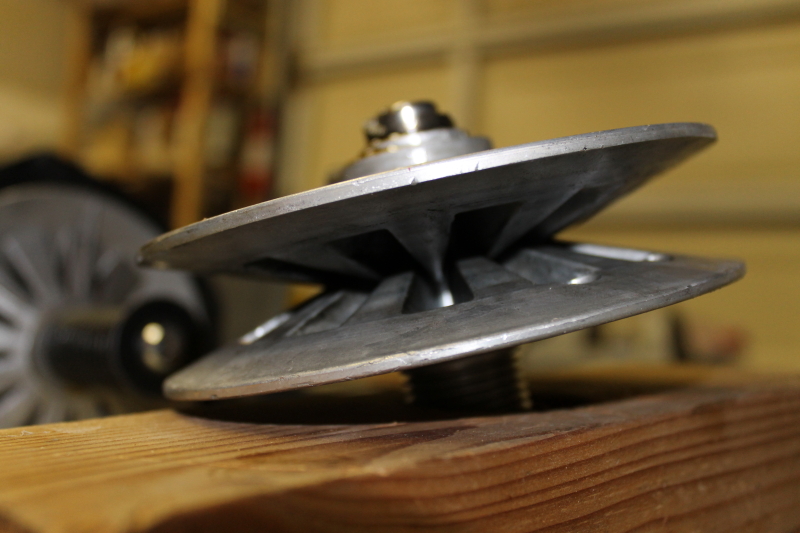

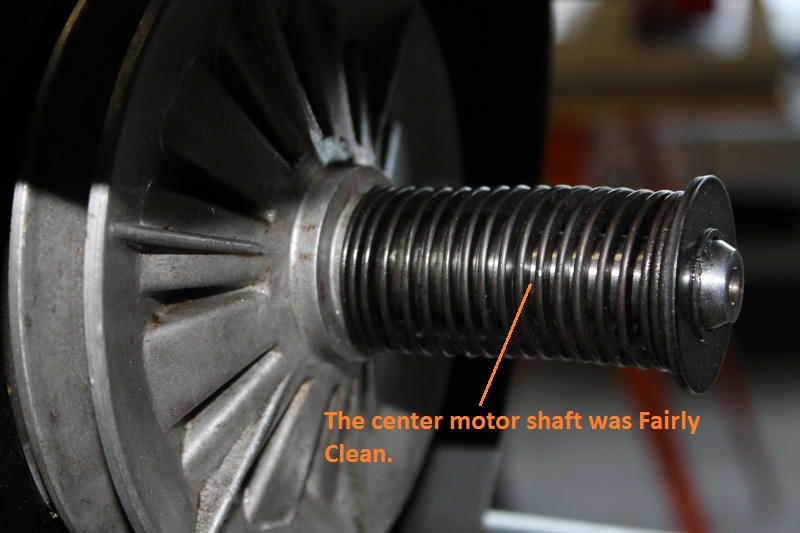

OK Sheaves are off. Control Sheave will be replaced... The Floating Sheave came off with almost no resistance to the gear puller. I had it 60% off by simply turning the gear puller by hand with NO wrench. If I would have lubricated the gear puller maybe I'd have gotten it all the way off.
I've cleaned the motor and idler shafts, and will do so again tomorrow. Tonight I still need to take the motor out of the housing as there is a ton of saw dust caked on the back end of the motor.
The crud was caked on the shafts and my clean mineral spirits didn't touch it at first, sort of surprising. Bore cleaner stripped the junk right off.
Here's a couple of pics of the newly freed parts.
[ATTACH]16281[/ATTACH]
[ATTACH]16282[/ATTACH]
[ATTACH]16283[/ATTACH]
I've cleaned the parts up quite a bit, but would like to get them even cleaner. Does the inner sheave sleeve need to shine as mine appear almost blackened?
Can I use Brake Cleaner on the parts if cleaned well afterwards?
Up next is the Quill Assy and all to be removed/cleaned/lubed....

Just a warning. Try to get a return policy from whomever you get the replacement Control Sheave. Due to manufacturing tolerances over the years when cutting the keyway and boring the internal shaft ID, you may find the sheave vanes hitting and maybe will stick in each other when closed or the control sheave ID will be too tight or too loose on the idler shaft. If buying used, try to buy a complete Control & Idler sheave and idler shaft assembly.
Any solvent that works should be ok unless is dissolves aluminum or steel.
As far as color, if the parts slide easily when oiled then they are probably clean enough, but if a deposit is causing the color, it is best to remove it. Abrading may be the only choice. Roll up a piece of sandpaper and run it(as a rolled up cylinder) through the bore to clean it up. Keep the paper dry! Do not over do it to the point the bore is getting bigger.
I would take the idler sheave off the shaft to get down to the center of the shaft. There is a small clip(that fits into a small groove on the idler shaft) that retains the idler sheave. Once the sheave is removed, the key will also come out. Then cleaning the shaft becomes much easier. Take care to not misplace the clip. You will not find one at your friendly hardware store(or big box place either).
