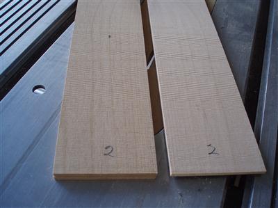

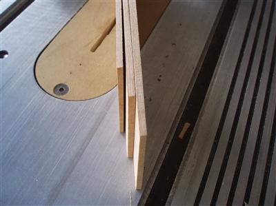

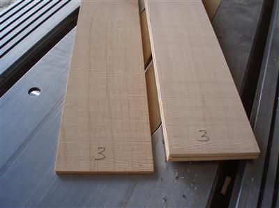

Resawing, Progress Report
I have done all the test cuts that I think are necessary. If I pay attention during the cuts, I can now achieve clean enough cuts to go directly to veneering with very little sanding.
I had two problems that needed to be resolved. One was too rough a cut from the resaw blade I had and the second was variable thicknesses.
The 1/2" Woodslicer 3-4 tpi seems to have resolved both.
[ATTACH]18548[/ATTACH]
[ATTACH]18549[/ATTACH] [ATTACH]18550[/ATTACH]
[ATTACH]18551[/ATTACH]
The stripes that you see in images 2 and 3 are not a optical illusions. Those are slightly rougher areas bordered by smoother areas. The rough areas can be made smooth with two or threes passes with a sanding block.
I'm going to glue up now but will probably be back to determine "why the rough areas".

Dusty, those cuts look very nice, especially considering the original cuts you were getting. The key to smooth cuts on the bandsaw is a slow and steady feed of the wood through the blade. I don't know if you're using one, but a feather board before the blade that hits the wood in the center of it's width helps a lot in steadying the stock as you feed it into the blade and gives you less to think about as you saw the wood.
Another thing that sometimes helps smooth a cut is a bit more tension, but one doesn't want to over do it because the Shopsmith is really a light bandsaw. Also, the gap between the blade and the guides allows the blade to wander a bit and can add to the roughness. If you're using cool blocks, they can be moved right against the blades but they'll wear much quicker. As longs as you're not overheating the blade while sawing with the blocks touching the blade, there is no real problem except for wear.
Art in Western Pennsylvania
pennview wrote:Dusty, those cuts look very nice, especially considering the original cuts you were getting. The key to smooth cuts on the bandsaw is a slow and steady feed of the wood through the blade. I don't know if you're using one, but a feather board before the blade that hits the wood in the center of it's width helps a lot in steadying the stock as you feed it into the blade and gives you less to think about as you saw the wood.
I am running with a little bit less tension than I would have with the old resaw blade so I'll increase tension a little and move the cool blocks in against the blade.
We'll see tomorrow if that makes a difference.
