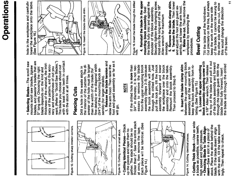

If you have the blocks, mounting a blade is relatively simple. All the 'fixture' does is align the blade to the block clamp. That can be done without the fixture, but the fixture does make it quicker and easier. Make sure the blades are inserted far enough and both ends are the same.
BTW did you get the L shaped blade clamp shim?

But you do have the fixture as it is built in to your table shown in this picture from your post. Technically, you have two of them.;)

mrhart wrote:I have the blocks which are two pieces and a set screw, one of them in L shape, otherwise I know not of what you speak and dont see it on the pic you sent.
The "L shaped" tool I referred to is used when you reattach the top end of a blade to the block for inside cuts. The 'tool' prevents the block from rotating as you loosen/tighten the clamp screw.
pn 515215 in my manual.
See fig 15
