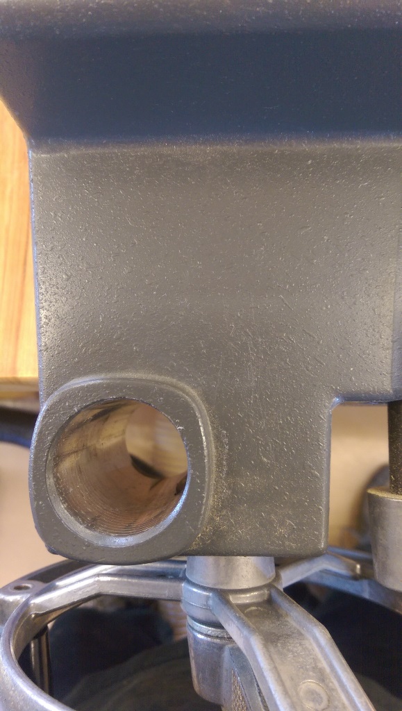

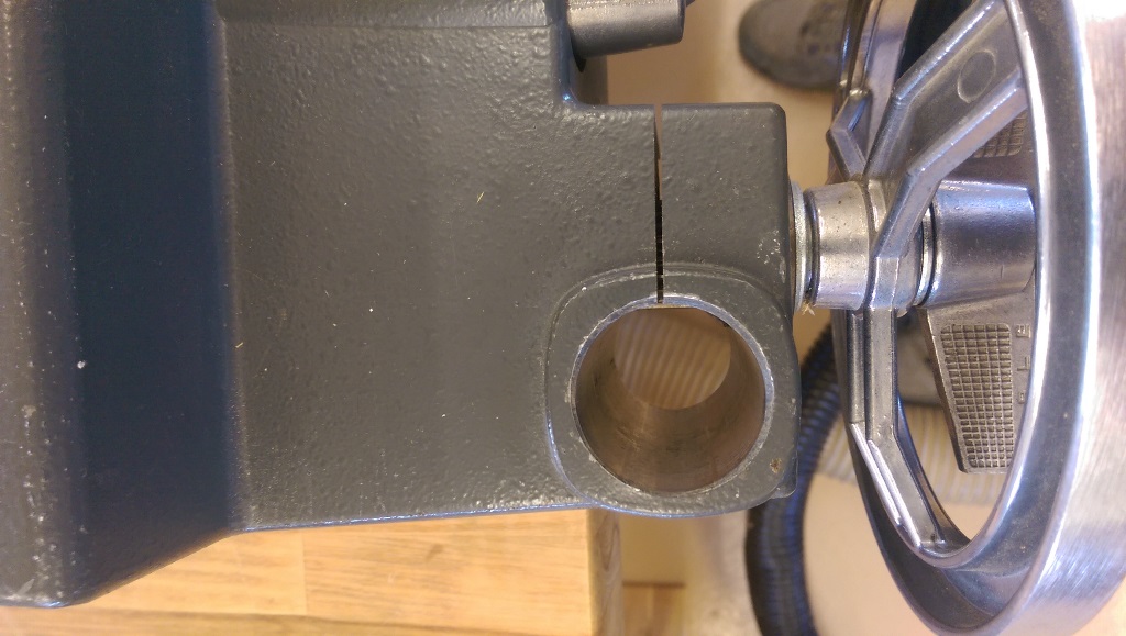

Also somewhere along the line SS made a change. The one with the slit is the bad one and it is from my original machine that I bought new in 1984-85. The shorty and the dedicated drill press have the slit those and the one without the slit were bought on eBay. Vintage unknown.

I'm confused, John. Which Carriages have the slit? The good ones or the bad ones or is there a mixture?
For information only - none of mine have the slit.

dusty wrote:I'm confused, John. Which Carriages have the slit? The good ones or the bad ones or is there a mixture?
The one on the shorty has the slit bought on eBay. The one on the dedicated drill press has the slit bought on eBay. They are both good. The one on the MK 7 originally bought new by me in 85 as a 510 has the slit and it is bad. The extra one with out the slit was bought on eBay.
