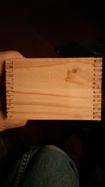

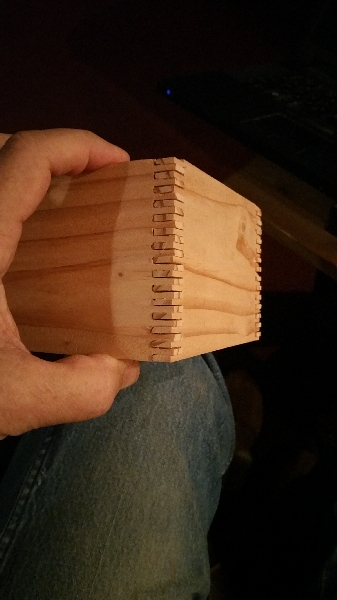

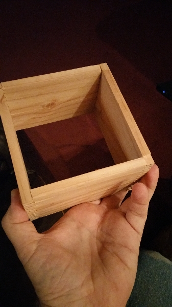

Since I started this thread, I thought I would add one more thing. As I posted in the "other" thread on the Ibox:
This is the most incredible addon I have bought so far. I got mine in yesterday (I was out of town) watched the video last night twice to drill in my pea brain how to put it together. Made a quick box this morning after putting the jig together .... a perfect 1/8 inch finger joint box the first time.
To say the least, I am impressed!
Thanks everyone for your feedback. I have used it and made a box in 30 mins. What can I say, for a raw beginner, it made it easy ....
These pictures are raw, no sanding, no trimming, just as they came off the jig .... :D
ibox first box 01.jpg (139.24 KiB) Viewed 10817 times
ibox first box 02.jpg (125.97 KiB) Viewed 10817 times
ibox first box 03.jpg (120.37 KiB) Viewed 10817 times
Dick

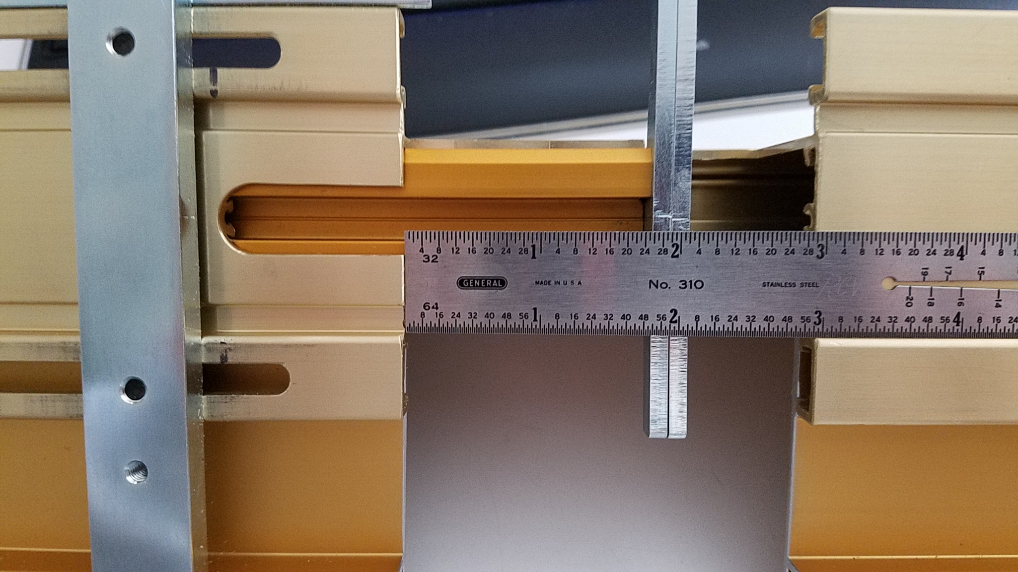

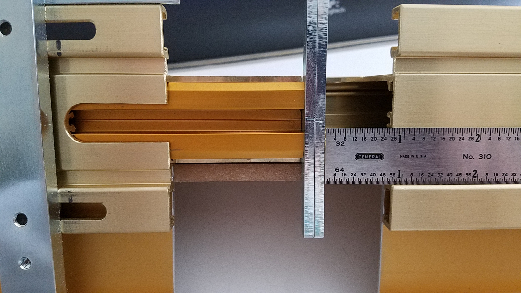

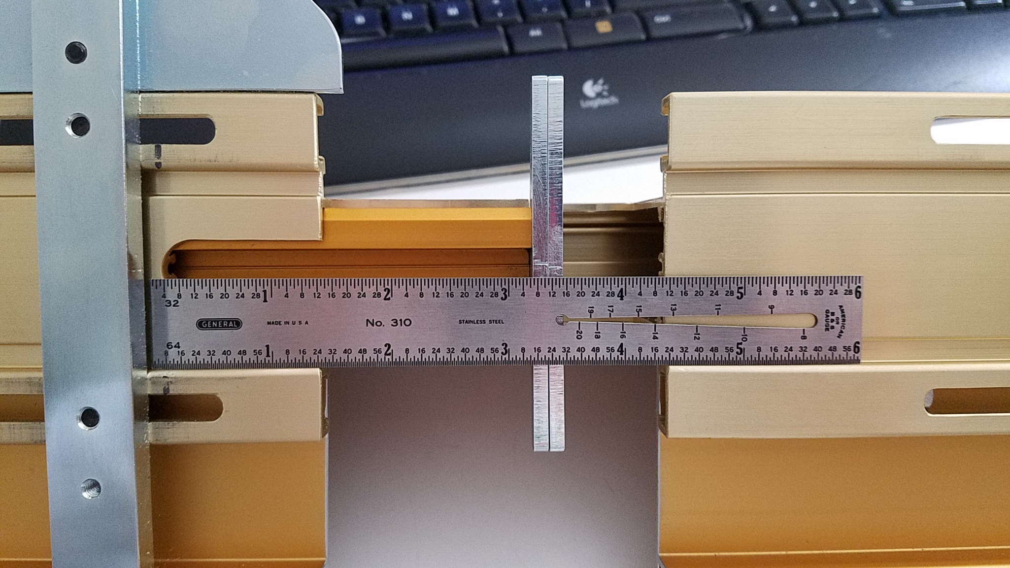

Yes, the arbor/blade establishes the reference surface. But you must understand that while I am sitting here at my computer there is no reference surface (at least no reference system that involves either the blade or the arbor). I am still able to perform valid adjustments to the I-Box.
These three images show the I-Box sitting at my computer table. In the first image, the end of the ruler depicts the "reference surface". That reference will be altered by absolutely any and every adjustment that I might make to the I-Box. However, I can return to this exact location without referencing the arbor or the blade.
I-Box Reference Surface 008.jpg (1.78 MiB) Viewed 10801 times
I-Box Reference Surface 009.jpg (1.76 MiB) Viewed 10801 times
I-Box Reference Surface 010.jpg (1.79 MiB) Viewed 10801 times
