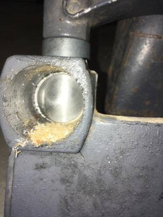

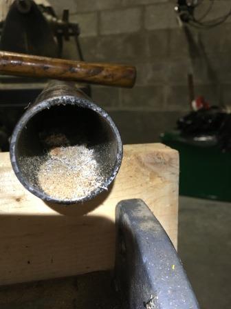

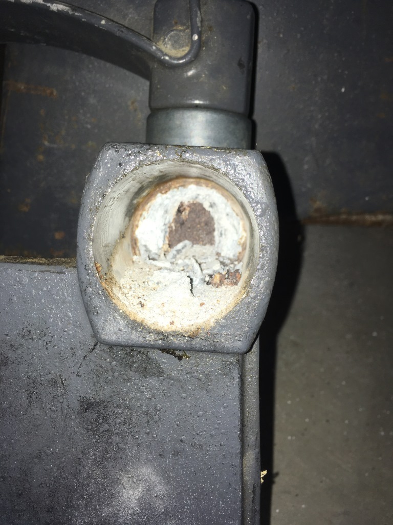

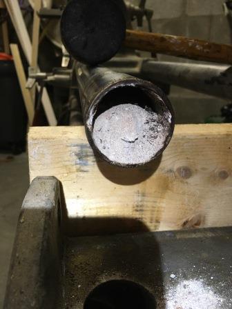

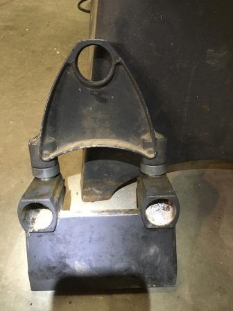

Well Boys,Progress, and I'm screwed. Looks like new parts will be required.
See the pictures below.
I think the lesson learned in Take your machine apart periodically and clean everything. Especially those of us that have to store it in the Garage in uncontrolled environment.
Tailstock fixture removed.  It tok me a while until I figured out there is a set screw on eacj tube, accessed from the underside. Once I turned over the rail/headstock assy.  Located screws, added JB Blaster.  Then turned back upright and re-installed.  then I COULD USE THE WEIGHT A FIXTURING TO KEEP THE WHOLE THING FROM MOVING AS I WHACKED OFF THE TAILSTOCK ASSY.
The good side.
The good side.
what is this crap? The tube is filled with it.Corrosion residue, of course.  How does this happen?
The bad news.
The bad news.
Corrosion in the tube.

Every once and a while, there's been a discussion about filling the tubes with stuff (everything from lead to cement) to make the Shopsmith heavier and less susceptible to vibration as a lathe. Maybe that's what this is? Or is it only in the ends of the tubes?
carpfisher
Posts: 21
Joined: Sun Feb 19, 2017 9:59 pm
Re: Tailstock stuck in MK V
Post by carpfisher »
algale wrote:Every once and a while, there's been a discussion about filling the tubes with stuff (everything from lead to cement) to make the Shopsmith heavier and less susceptible to vibration as a lathe. Maybe that's what this is? Or is it only in the ends of the tubes?
This was a "natural Occurrence" of some sort. Neither my Dad or I added anything to the tubes. My gut reaction is that is is corrosion offal of some sort but the shear volume is incredible to me. It was on in one tube, the one that corroded. There was some sawdust on the other and no corrosion in that one.
I sent a note to SS to see if they have seen this before.

You will probably never know but it seems to me that something got spilled on that tube at some time. No reason for one to corrode like that and not the other one.

I am with you on that one , some thing has been spilled on it .

Spilled: I suppose but as noted. I suppose we'l never know. It looks like the new parts are $130.00. I want to verify I am ordering the right parts on Monday with SS. I have a friend with an arbor press and were gonna mess with it and see if we can pop the parts apart.
