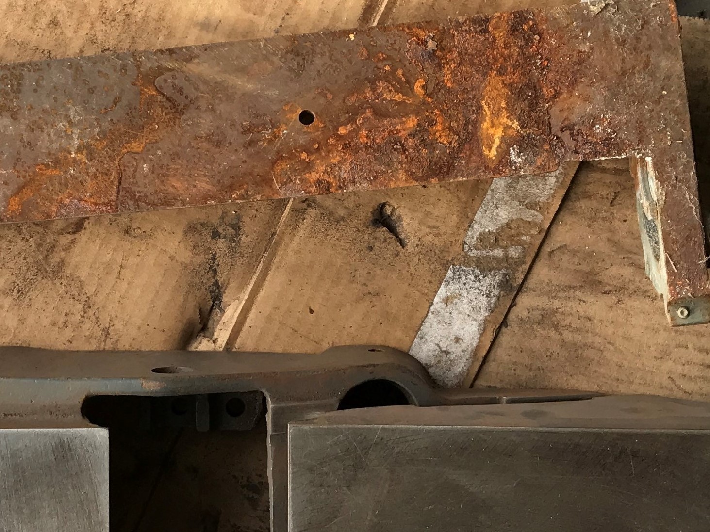

I have the Jointer setup like yours on my Model 10ER and as you have been already cautioned these parts are rare. One nice thing about the Jointer itself is many of the parts are the same as the current Shopsmith Jointer. After the Model 4E Jointer was made it was changed to connect to the Mark 5 with the mounting tubes used for all SPT's (special purpose tools.) The only difference between the Model 4E and the Model 620 was the outfeed/base changed to use mounting tubes for the Mark 5, it still had the holes for the Model 10 mounting bracket. Mine had the threads stripped out in the quadrant and I ordered a new one from Shopsmith. That like many of the parts hasn't changed in all these years. There are changes and upgrades though. The adjusting knob to change the thickness of the cut changed along with its threaded shaft and must be replaced together. The same is true for the fence lock handle which must be replaced as a set with the special "bolt" and "nut." More recently the cutter head diameter changed along with the blade wedges. The bearings are still the same as is the blades. There have also been safety improvements like the rear blade guard behind the fence and the drive shaft guard. Use caution removing the rust from in/out feed and fence surfaces to keep them flat. Check the surface of the in/out feed tables after reassembling them with a flat edge to make sure they are even. The last one I restored, a 620 Greenie, had to be adjusted to make the in/out feed tables true. It's also the one in the picture with rust still on the fence but the tables restored. Sorry it is so cropped down, I need a new photo editing program. The pulley assembly you have for it being a separate 5" pulley from the step pulley is needed when using a speed changer so you can reverse the step pulley leaving the 5" pulley out. Anyone not using a speed changer can use a 4 step 2/3/4/5" pulley connected directly to the motor shaft. My 4E Jointer attached to my Model 10ER works just as well as my newer one connected to a Mark V.
- Model 620 Jointer fence and tables
- IMG_0158 rc.jpg (463.04 KiB) Viewed 14940 times

Interesting post Russ. Thanks for sharing that!chapmanruss wrote:I have the Jointer setup like yours on my Model 10ER and as you have been already cautioned these parts are rare. One nice thing about the Jointer itself is many of the parts are the same as the current Shopsmith Jointer. After the Model 4E Jointer was made it was changed to connect to the Mark 5 with the mounting tubes used for all SPT's (special purpose tools.) The only difference between the Model 4E and the Model 620 was the outfeed/base changed to use mounting tubes for the Mark 5, it still had the holes for the Model 10 mounting bracket. Mine had the threads stripped out in the quadrant and I ordered a new one from Shopsmith. That like many of the parts hasn't changed in all these years. There are changes and upgrades though. The adjusting knob to change the thickness of the cut changed along with its threaded shaft and must be replaced together. The same is true for the fence lock handle which must be replaced as a set with the special "bolt" and "nut." More recently the cutter head diameter changed along with the blade wedges. The bearings are still the same as is the blades. There have also been safety improvements like the rear blade guard behind the fence and the drive shaft guard. Use caution removing the rust from in/out feed and fence surfaces to keep them flat. Check the surface of the in/out feed tables after reassembling them with a flat edge to make sure they are even. The last one I restored, a 620 Greenie, had to be adjusted to make the in/out feed tables true. It's also the one in the picture with rust still on the fence but the tables restored. Sorry it is so cropped down, I need a new photo editing program. The pulley assembly you have for it being a separate 5" pulley from the step pulley is needed when using a speed changer so you can reverse the step pulley leaving the 5" pulley out. Anyone not using a speed changer can use a 4 step 2/3/4/5" pulley connected directly to the motor shaft. My 4E Jointer attached to my Model 10ER works just as well as my newer one connected to a Mark V.
Amazing that the jointer works as good, testament to a good design ....

While I wait for my rust dissolver to get off the delivery truck today, I actually did more on the jointer than any of the rest of the machine, as it seemed easiest to start on for now. I ordered those bearings (rubber sealed versions this time) and cleaned up the cutter head. If I tape off the surfaces that the blades and wedges seat against, and the shaft bearing seats, can I paint the cutter head itself?

I do not see any reason you could not paint the cutter head as long as you keep the blade/wedge area and shaft ends clear for the blades, wedges & bearings. I restored my 4E Jointer over three years ago and the cutter head still looks new. I keep it stored with a Shopsmith Jointer Cover on it and it is still free of rust. Remember waxing any bare metal surface will help keep rust away. I do not remember if I waxed the cutter head but the table and fence surfaces have been done a few times now. I'll have to remember to wax the cutter head the next time I remove the blades. An ounce of prevention is worth a pound of cure.
