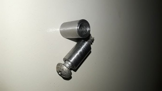

Let's go ahead and check those switch spacers off the list as well.
Mike -
Mike -
- crudelymadespacers.jpg (17.62 KiB) Viewed 1528 times
