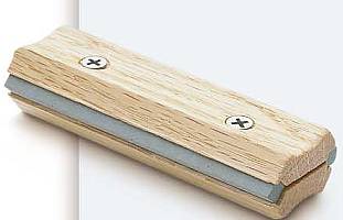

OK just one more. A very long time ago I picked up a knife hone for my jointer that you use with the blades still in the jointer. One side has a course grit for small nicks and the other a finer grit to do a light touch up. I think shopsmith use to sell them so I may have purchased it from them or maybe some other mail order place. I was going to pull it out and take a picture but it has hectic week... however I did find it online at:
http://www.mlcswoodworking.com/shopsite_sc/store/html/smarthtml/pages/accessories.html
Just look for the item #9134
[ATTACH]3609[/ATTACH]
BTW item 9397 is what I use to set my jointer blades or at least this one looks a lot like it.
