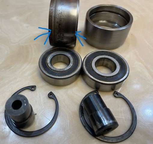

JPG wrote: Tue Sep 24, 2024 11:42 am You are fortunate to have the metal idler pulleys. Take good care of them.
If you may need to use it with the internal sanding belt arrangement, I recommend you get one of the current plastic pulleys since then one pulley face bears against the abrasive side of the belt.
As for that mystery slot - Only the shadow knows. I do not.
Thanks for that Info.
We have scrap drops/extra stock of UHMW at work I am going to make a couple of spares.
I will leave the Metal wheel in the back for outside sanding setup.
Thanks for the info. :)
I had to go to U - Tube to understand what you were referring to about internal sanding.
I am learning so much from Ya'll.

chapmanruss wrote: Tue Sep 24, 2024 2:49 pm Hopefully some of the literature you received includes a copy of the Strip Sander Manual. Yours is currently set up for internal sanding having the one Idler Wheel below the top Tracking Wheel instead of its normal position at the back near the same level as the lower Idler Wheel.
I didn't get a manual.
After you and JPG said internal I was :confused:
So I went to you Tube. :D
I understand now :)
I will make an extra wheel that I can leave in position.
Thanks Again.
Now I got to go do some playing and Measuring. :D
Dwayne

Here is one of the pieces of literature.
I did get the Metal wheels disassembled.
Thanks JPG and Russ for your input. :D
I am glad one of them is still in Great shape.
The other can still be deburred and put back into production. ;)
Dwayne

Adding an extra Idler Wheel to have one in each of the three positions would be a bit of a time saver when switching from normal sanding to internal sanding. I don't believe having an Idler Wheel in the upper internal sanding position would interfere with normal operations. Interesting that the service parts list has the Idler Wheel (ref # 17 and part # 516399) itself as unavailable.

I can verify that having a new plastic/bronze sleeve bearing pulley in that upper location will NOT interfere with 'normal' operation.

Upon looking at the manual I realized that two plastic idler 'wheels' are a good idea. :o

I found some Material at work today for the extra roller. :)
