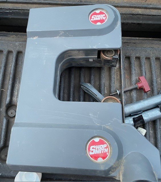

I may have Overlooked or just do not have the other Dovetail piece that goes on the guard itself.
Thanks for the pictures. :)
I was wondering what that big guard was I have at least one of those. ;)
It's this
Mark V 510 51-014654

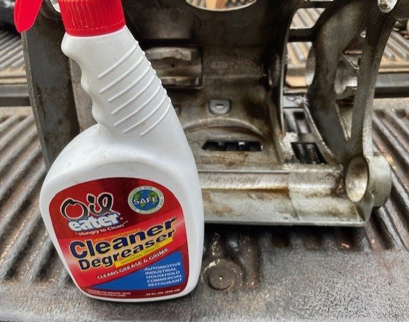

A little Progress.
Final Cleaning pictures coming soon. :)
Cleaned the headstock out and will be looking to get a Sticker.
I know there are older threads about the (Disappearing sticker) :D
This is some good Cleaner IMHO / Better than 409 :cool:

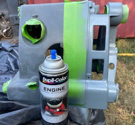

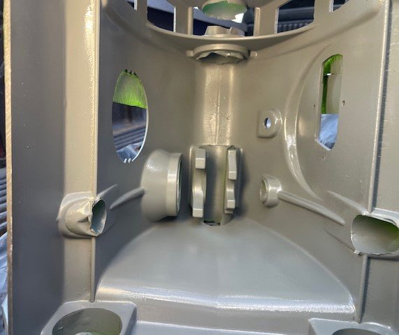

Okay I have made a decision to paint the bare cast inside with a light gray engine paint.
Maybe that will help with the cleaning in the future.

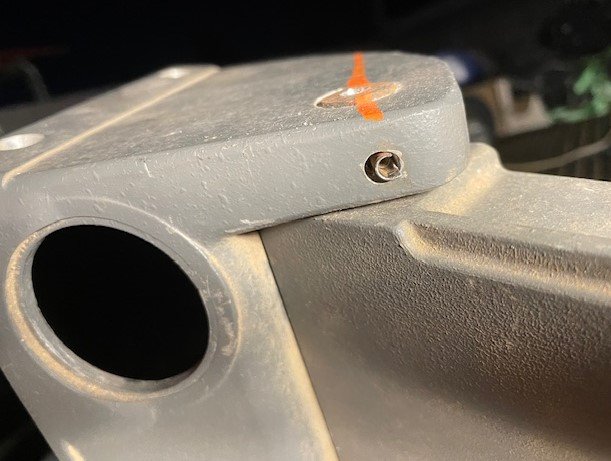

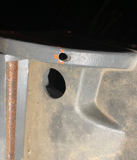

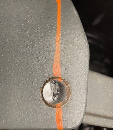

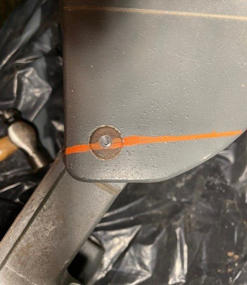

Before removing the roll pin in the tilt base, I noticed that the pin was flared. :eek:
I drilled the back side of the base to have access to the rear of the pin.
This pin was Stuck :rolleyes:
So I drilled the end of the pin till it separated at both ends,
I will replace the pin with a new one.

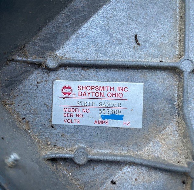

I just received a New to me attachment tonight.
A Shopsmith friend of mine shipped this to me over the weekend.
I got a great deal on it an extra literature of other stuff as a Plus.

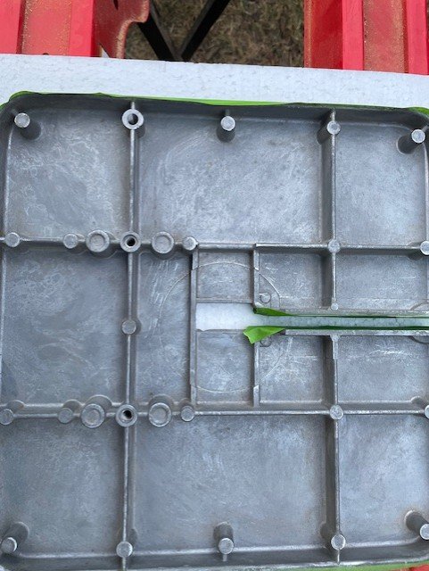

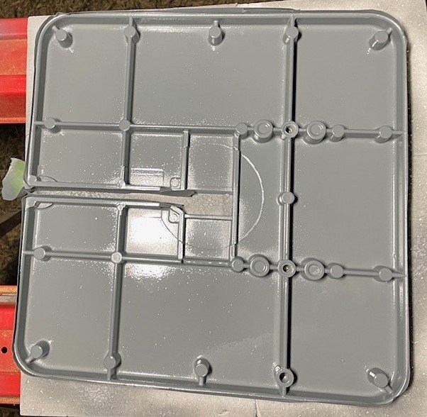

As I unboxed the Strip sander,
I noticed the same thing that there was not a lot of Deburring of flashing on the cast parts from the factory. :)
I deburred the bottom of the strip sanding table and painted it the same color I painted the inside of this 1984 headstock.
It is in pretty good shape. :)

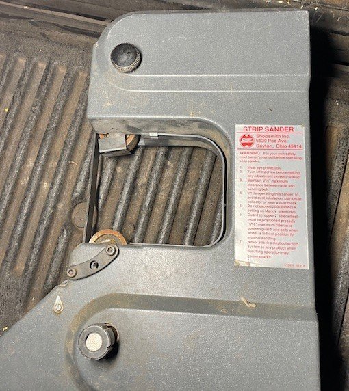

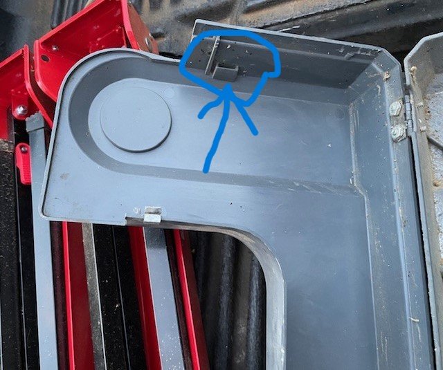

Does this slot have a Purpose?
After reading this label?
Is there an Upgrade for the strip sander?
This is it after the paint job.
The casting has a circular place like the Band saw / ??. :)
Dwayne
Re: Restoration of Mark V / produced on 11/84
You are fortunate to have the metal idler pulleys. Take good care of them.
If you may need to use it with the internal sanding belt arrangement, I recommend you get one of the current plastic pulleys since then one pulley face bears against the abrasive side of the belt.
As for that mystery slot - Only the shadow knows. I do not.
Posts: 4538
Hopefully some of the literature you received includes a copy of the Strip Sander Manual. Yours is currently set up for internal sanding having the one Idler Wheel below the top Tracking Wheel instead of its normal position at the back near the same level as the lower Idler Wheel.
