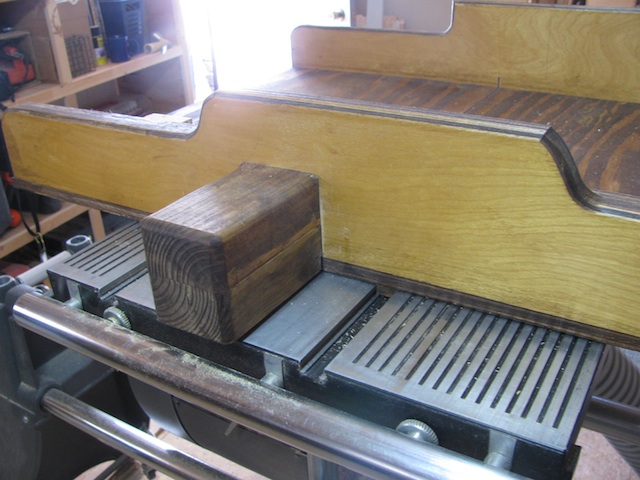

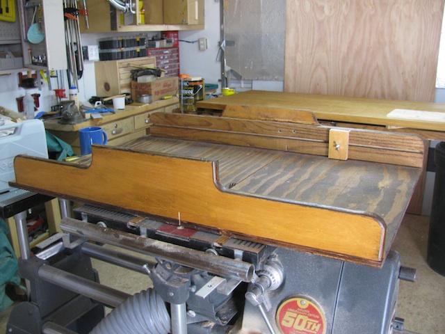

I finally got to finish my cross cut sled. Finishing some doors for a rental kept me from any dust making activities for a while. I made the base from new plywood, hoping to have a flatter base, that worked well. The front and back fences are recycled 3/4 ply from some very old cabinet doors, the blade guard is reclaimed shipping stickers from the rental doors and the runners are scrap red oak from a bed project. I set the fence with my largest Groz square and clamped it down and put in 1 screw. I did the 5 cut method discussed here earlier and on the first try, I got a difference of .0045 in. over 12.5 inches. I remeasured 4-5 times, to be sure I was not fooling myself and go similar numbers each time. I recut the same board again and got very close to the same values. I got .0049 over 12.25 inches on the second cut. I screwed the fence in place and made some test cuts that seem to be very good. I am pleased with the results. The stop block is just a 3/4 in ply block with a 1/4 in bolt and wing nut. The slot was made by cutting a slot in the 3/4 in fence, covering it with a 1/2 ply sheet and then cutting a narrower (1/4 plus) slot in that. I sanded, stained and sealed the sled and then waxed the runners and bottom. The runners took a tiny bit of scraping to remove a snug spot, but other than that it went pretty much as planned. I think I actually did this right and have a good working sled. Thanks to all for the help and advice.
crosscut sled.jpg (119.86 KiB) Viewed 3224 times
cross cut stop.jpg (121.42 KiB) Viewed 3214 times
crosscut blade cover.jpg (108.67 KiB) Viewed 3212 times
Dave

Thanks! I used it this weekend a bit and it seems to work well. yahoo! I tried to incorporate as many of the features that I saw other places that also were practical for me. Those are not always the same thing! Keeping the front fence flat by gluing and clamping the 1/2 in ply and the 3/4 in ply to my bench top was a great idea from some one. I also was able to flatten the sled bottom by clamping it to the bench top and then putting the back fence on. it really pulled the small amount of rocking out it. I would have never thought to leave a small rabbit on the bottom of the from fence for saw dust. I would not have left the stop block as short as I did either. The best part of the project was following along with Dusty and others as they shared all their ideas and experience. Dusty contributes the proper focus on precision, Farmer kept it pretty simple. I used Dusty's set up technique. Now that I have made one that I can use, I may try my have at some other types of jigs. I still think the best idea I saw was Dusty's! I just am not sure i could duplicate it.

I might share that one thing that ( I THINK)allowed me to square this up pretty much on the first try was a totally unintended event. My sled is longer on the right side and it hangs over the edge of the saw table. I was able to push the sled forward until the blade teeth were buried in the fence and still have the clamp I was using clear the table. Not possible with the headstock on the left. Total accident that I put the first screw on the left forcing adjustment on the right! I used a 2nd clamp to pull the square tight to the fence and the then I could move both the sled, the fence and the blade( rotation) to get a good square setting. This is important I think because my Groz square is only a 6 in model. I think having all that flex ability allowed me to work around the teeth on the saw. All of the adjustment was done off the smooth face of the plate. The fence clamp on the right was easy to reach and control while I used my left hand to align things.
