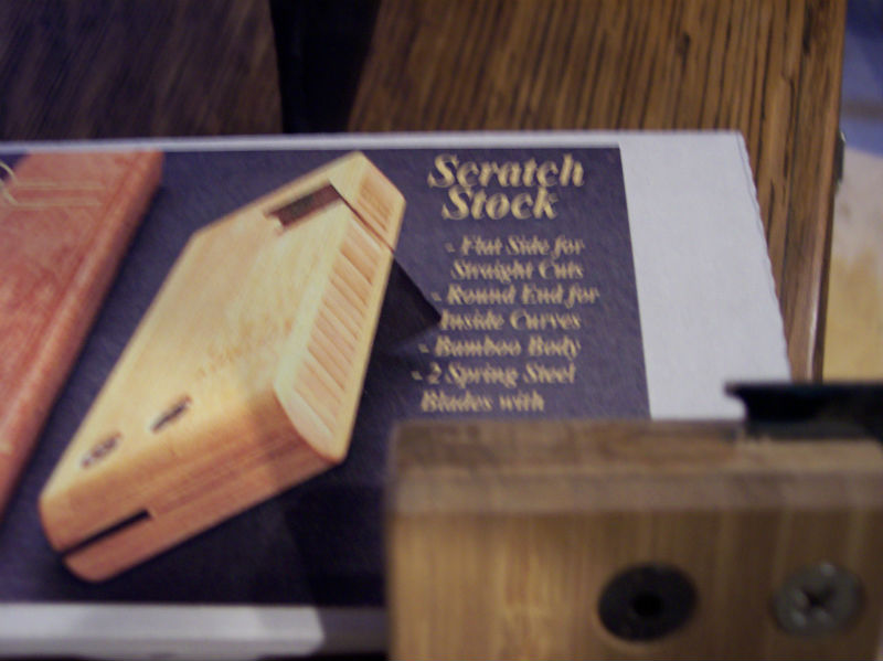

I heard about Scratch Stocks from Jim McCann & Nick Engler at the SS Owners Weekend in 2008; they demonstrated them. While they're simple enough to make yourself, I bought one last year from Hock Tools. This is real nice for cleaning out little beading details; I used it to get the tar-like bits of old finish out of the drawer beads:
[ATTACH]25194[/ATTACH]

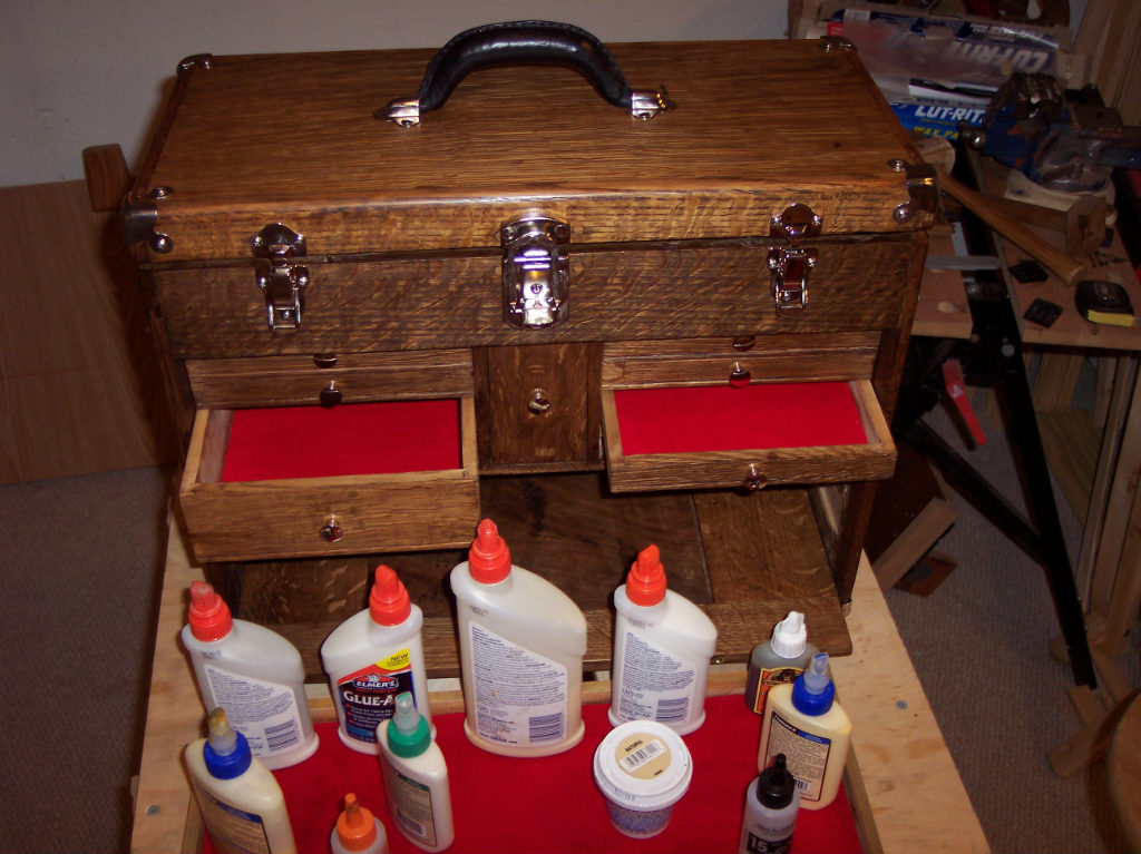

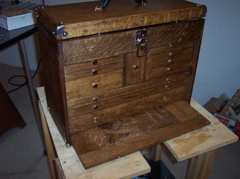

It was time to put on the drawer knobs after the drawer-fronts were planed, 'scratched', and refinished. The 11 drawers were really hard to manipulate in & out while the knobs were removed. Also I wanted to double-check clearances of the new front panel from all the drawers+knobs. Of 14 new knobs, 12 went in perfectly in the old holes. One needed a dab of Loctite, and one hole was bad enough to drill out, plug with wood, and redrill. Starting to look like a chest now!
[ATTACH]25193[/ATTACH]
- Knob Detail.jpg (110.02 KiB) Viewed 14891 times
- Scratch Stock.jpg (66.4 KiB) Viewed 14894 times

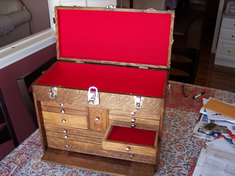

I've been pretty busy with other stuff lately, including a vacation in which I prepared a few turned pens for folks we were visiting.
Getting down to putting the felt linings in now. The drawers are trickier than the top bin since they have metal bottoms. So I've been using Gorilla Glue as a (sometimes foamy/messy) way to bond felt to metal. One drawer I'll probably redo as a bead of foam got out of control. I can do about 1-2 drawers after work each day:
[ATTACH]25411[/ATTACH]
- Red Velvet.jpg (164.41 KiB) Viewed 14867 times
Chris

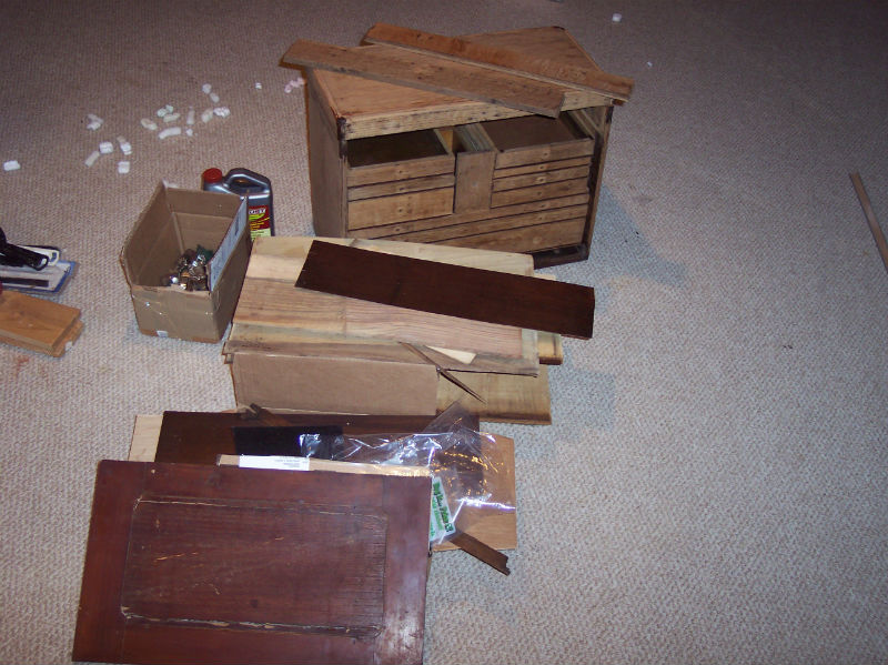

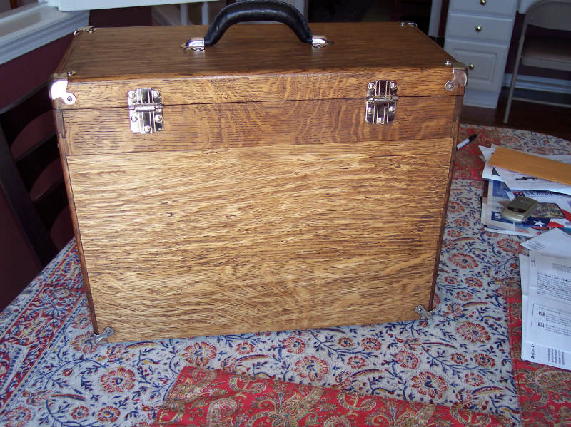

I'm finally ready to move on! This nephew will receive his chest in July:
Before:
[ATTACH]25480[/ATTACH]
After:
[ATTACH]25478[/ATTACH]
[ATTACH]25477[/ATTACH]
[ATTACH]25479[/ATTACH]
Before:
After:
- DavesChestBack.jpg (117.63 KiB) Viewed 14798 times
- DavesChestClosed.jpg (192.68 KiB) Viewed 14801 times
- DavesChestOpen.jpg (111.4 KiB) Viewed 14801 times
- Stripping Daves Chest.jpg (106.42 KiB) Viewed 14800 times
Chris
