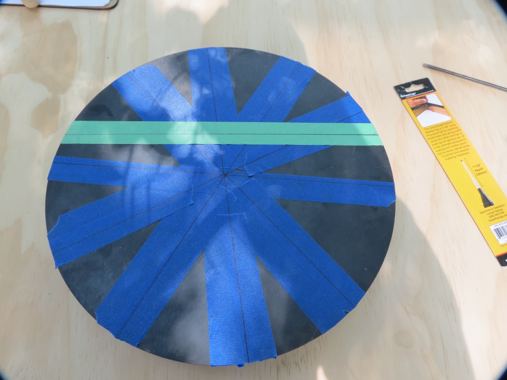

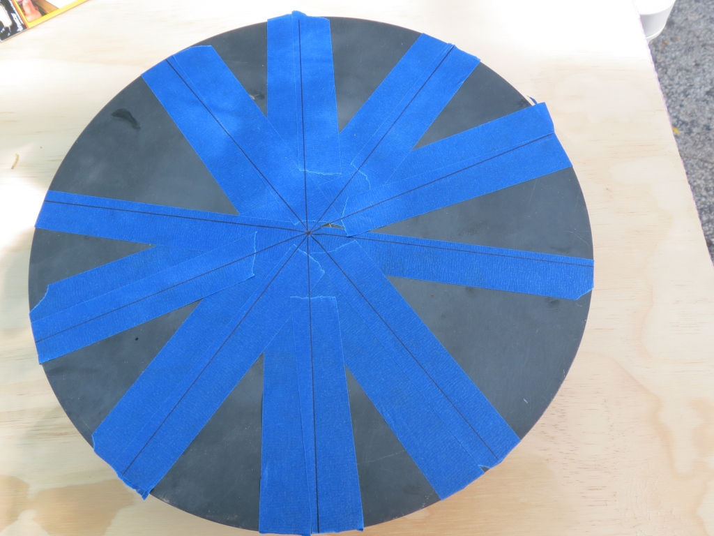

Getting a little warm again today to be working on my shelf unit so I took a few minutes to show my objection to using radial measurements when attempting to align to a disk in the saw slot.
I used some blue tape so you could see the black lines of where measurements might be taken. By definition radial measurements have to have the center of the disk as part of the line. So while I did not take any angle references I did strike the line through the center. Any number line segments could be added or taken away but they always have to include the center as a point.

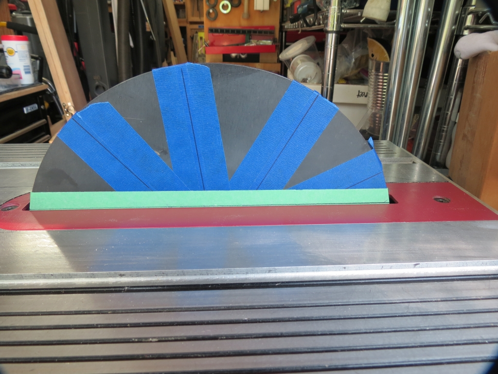

Now when we mount the disk on the shopsmith you can see the lines going off this way and that way.
Now I'll add a piece of green tape and make the line where the disk and table insert meet.
This line or a parallel line above/below it is the only location that I care about flatness(you define this line). Since this line is then the reference to which alignment is done or measurements can be taken. Any other points well they don't count and in fact don't even need to exist.
This line also needs to be perpendicular to the shaft of the shopsmith.

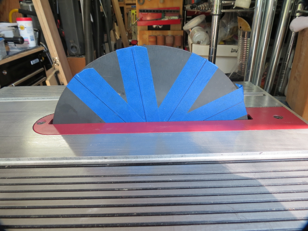

BTW this is where the line shows up with the disk removed.
I never did measure it but it is what it is and doesn't really matter.

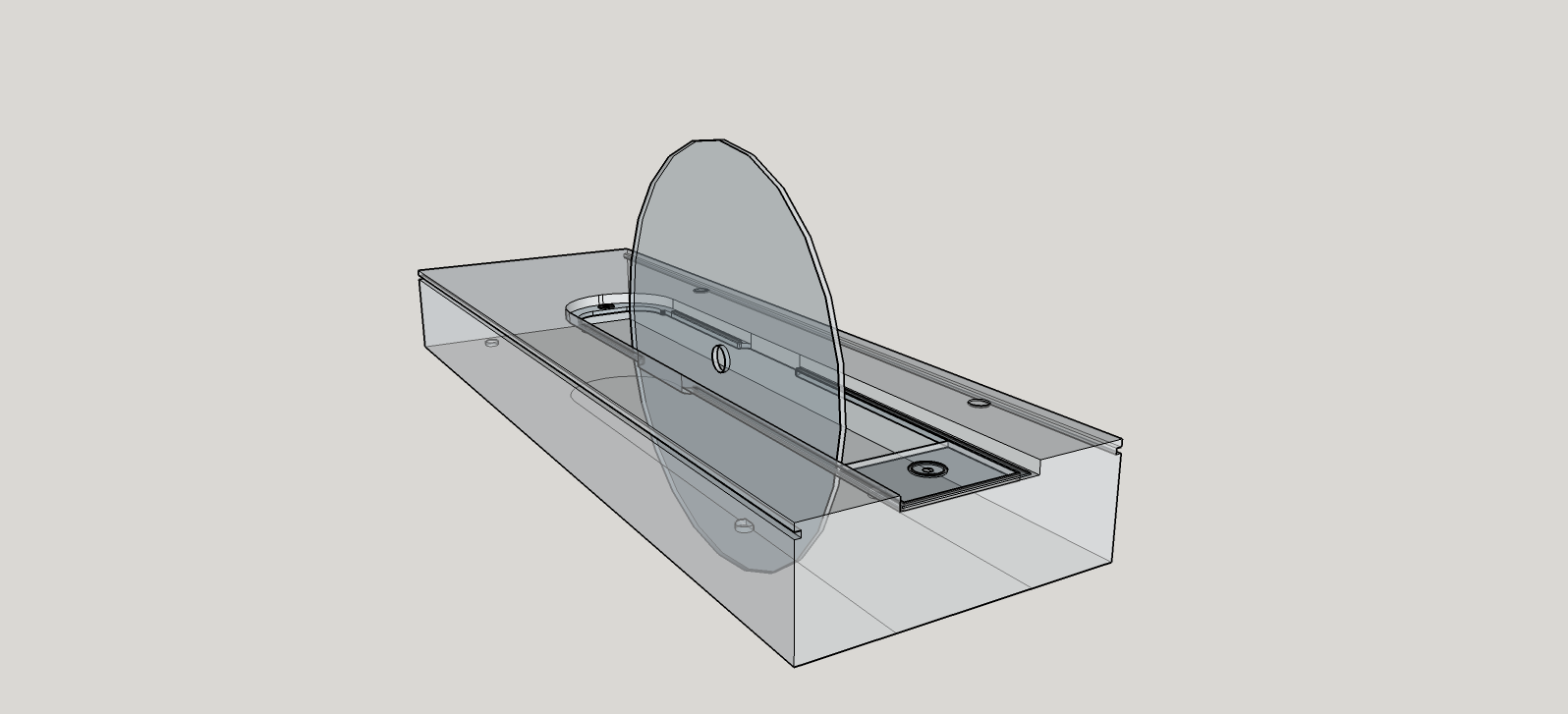

Details, details
Insert Cutout Area with Details.png (58.19 KiB) Viewed 6840 times

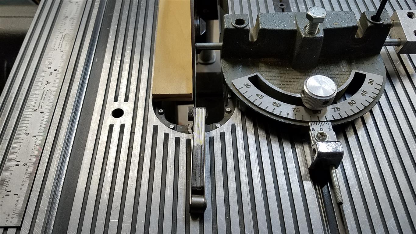

Down and Dirty Main Table Alignment
I have received some email feed back on my introduction to the set up plate that I recently acquired (My New Toy). Some read my comments in the thread as unreasonably critical and others feel that the application of a dial indicator is absolutely unnecessary.
I wholeheartedly agree with the later statement. Alignment can be achieved without a dial indicator.
Mark V Main Table Alignment (the simplest method I know).
Some assumptions to start with:
When properly aligned, the left face of the saw blade will be on the table insert center line. This further assumes that the carriage and headstock are pushed firmly against the rubber bumper, that the rubber bumper is standard Shopsmith dimensions and that the quill is fully retracted. Of course, all locks are secured.
Furthermore, the holes for all four trunion bolts have been drilled to a ½” diameter. On some rear trunions these holes are only 3/8” in diameter.
Procedure:

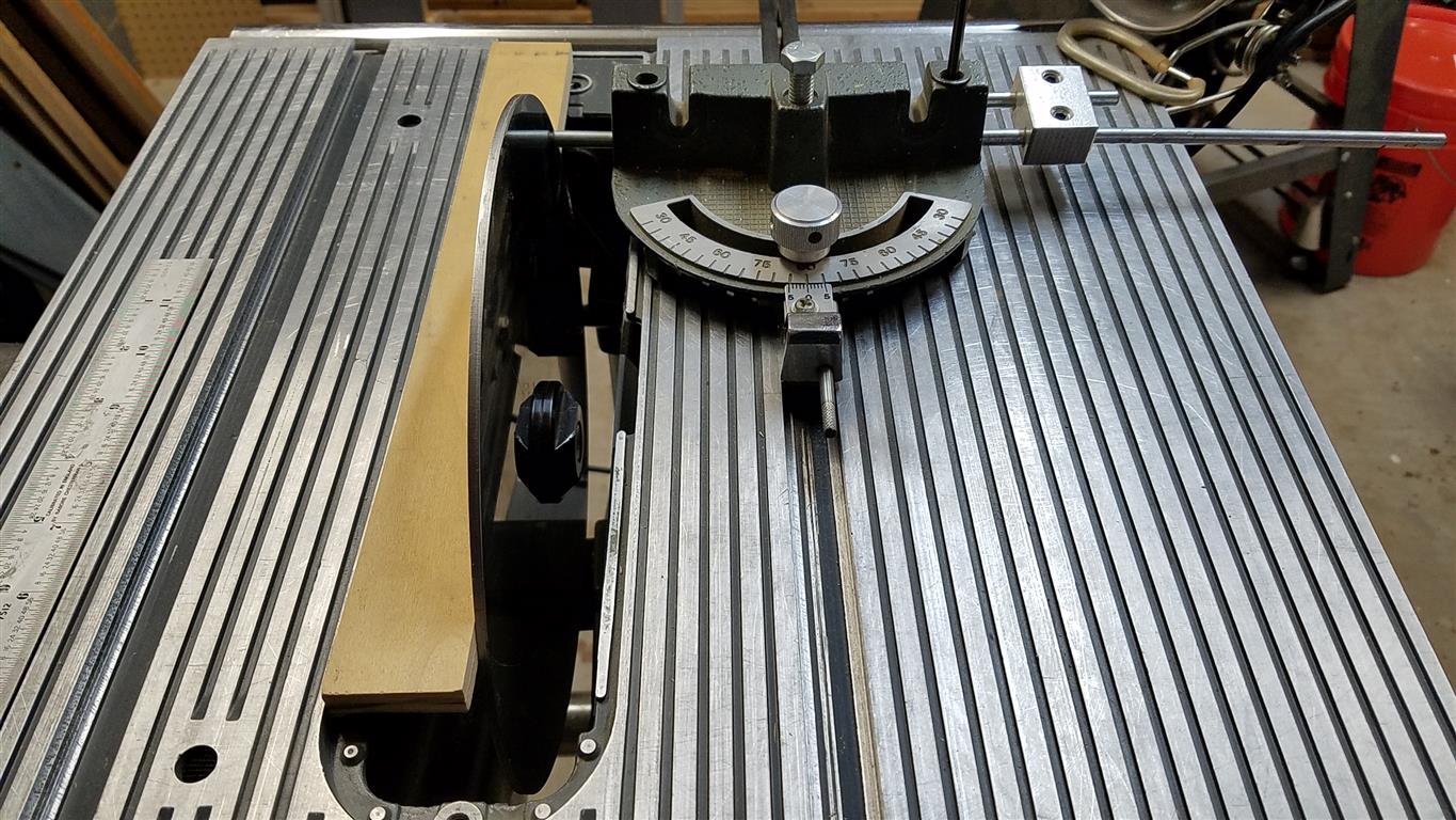

Loosen all four trunion bolts and apply pressure to the right side of the Main Table. The table will slide left until the table makes contact with the trunion bolts. At this point the table (the miter tracks) will be very nearly parallel to the saw blade and the center line will be at the left face of the blade.
Make measures by whatever method suits you to verify parallelism of the miter tracks to the blade. Even a simple measurement using a steel rule will confirm this.
If parallelism does exist, tighten the trunion bolts and go make saw dust.
Doing what has been described here and NOTHING more, the blade on the subject Mark V is .008” closer to the miter track on the outfeed side than it is on the infeed side. Some may consider this a hazard due to the potential to squeeze the blade against the rip fence. I do not consider this a safety issue at .008" but if it was I would compensate for that when I adjust my rip fence.
The piece of Baltic birch plywood that you see in these photos measures 1 28/64” while the setup plate measures 8/64”. The table cutout measures 3 1/64" wide. You can use that data for whatever purpose it might serve.
NOTE: No fancy tools, no micrometers, no dial indicators. Just a feeler gauge and a couple of standard Shopsmith accessories.
This, BTW, is the procedure I was taught when I acquired my first Mark V.
