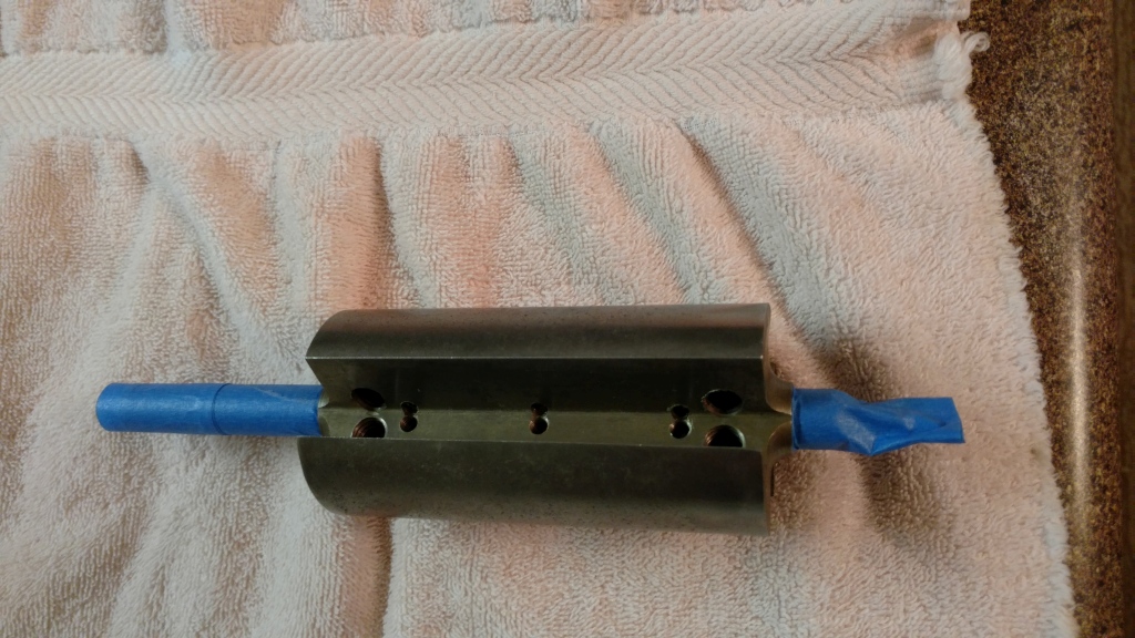

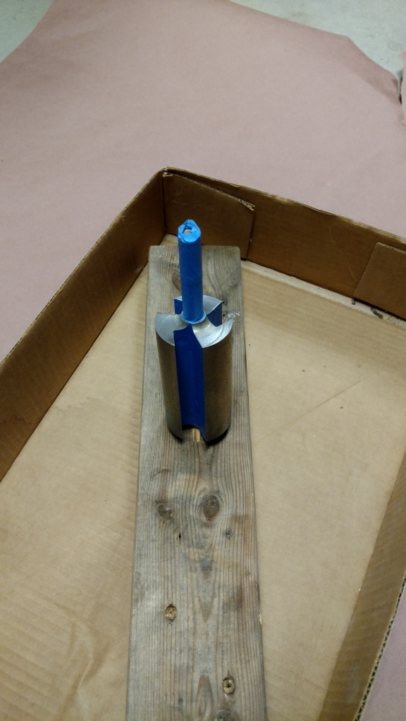

badtheba wrote:While I wait for my rust dissolver to get off the delivery truck today, I actually did more on the jointer than any of the rest of the machine, as it seemed easiest to start on for now. I ordered those bearings (rubber sealed versions this time) and cleaned up the cutter head. If I tape off the surfaces that the blades and wedges seat against, and the shaft bearing seats, can I paint the cutter head itself?
Something you might consider: For the cutter head, (and any other metal parts, where the black finish is worn) is to take a look at gun bluing solutions. In addition to the protection they provide, they add no appreciable build up on the surface, and the cost is minimal.

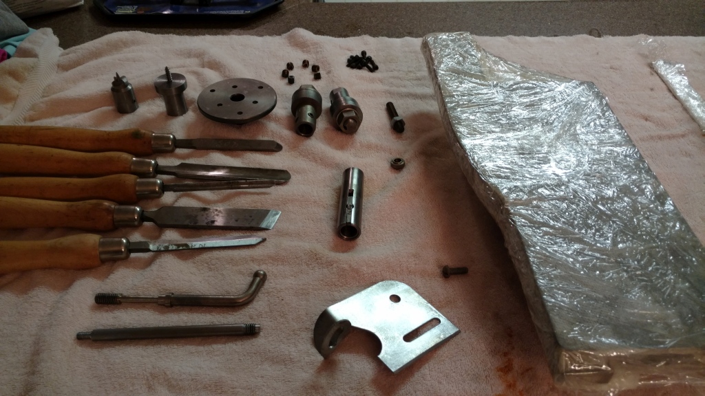

Round 1 of Evapo-rust. It was worth the wait, got a gallon for only $16 from my wife's work, HF was $26.
I am pretty happy with the results, with most of the small parts taking 3-5 hours before I could brush and rinse them clean. The cutter head was sightly pitted on the outer surfaces, but I was pretty impressed with how clean it came out. Almost looked like I had polished parts of it.
Right now I just sprayed wiped them down with T-9 (other than the cutter head that I'm painting). Is the paste wax recommended on things like arbors and lathe spurs too?
Pictured also is the saw splitter that I received today. Cost $10 total from someone in the Yahoo users group. Were these parts zinc coated? This one kind of looks like it.

You are saving your Evaporust for reuse correct? I filter mine through a filter like Mr. Coffee filter then store it for later use.
If the temperature is 80 or above, it works faster, so leaving it in a cold shop overnight can take a good bit longer to work, and may evaporate more liquid.
Looks like you are well on your way! Looking forward to seeing things as they complete, but the in process photos are so valuable. I am glad you are sharing them with us.
