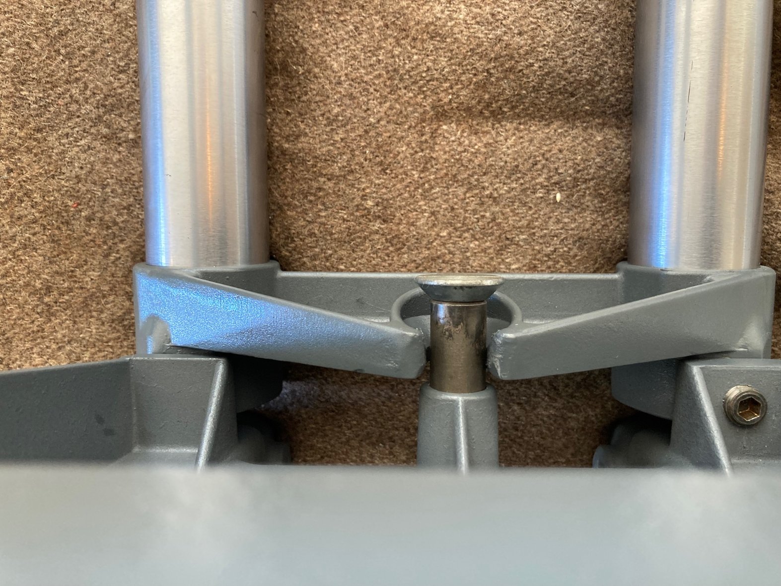

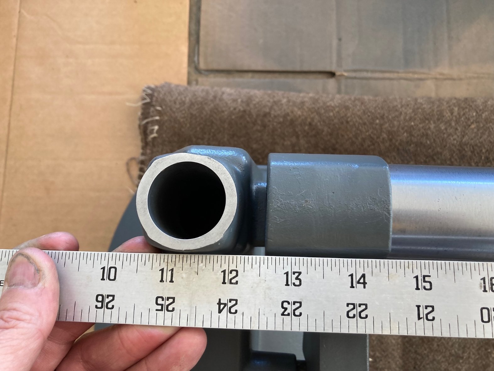

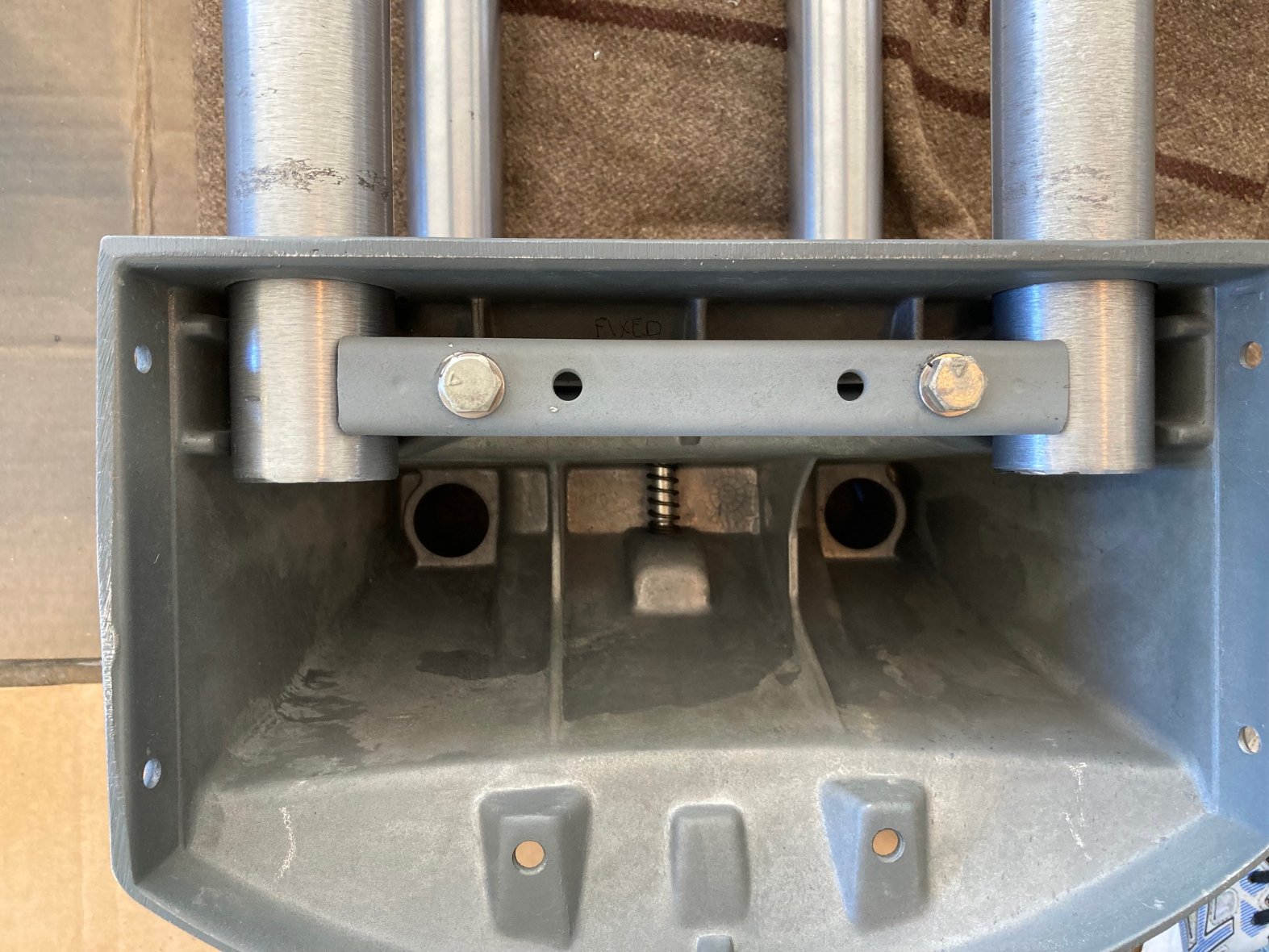

Re: Dad's 1982 Shopsmith Mark V Repair/Restoration Project
Russ, I repositioned the way tubes in the Headrest to reposition the Tie Bar and Headrest about an 1/8" gap (as viewed from underneath. Which, in retrospect is the gap that you were probably referring to in your response. The Way Tubes were moved further into the Headrest by about 3/8". I took a couple of pictures which I'll post here shortly. Let me know how it looks to you.

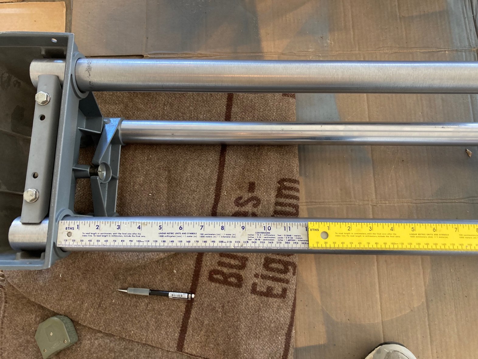

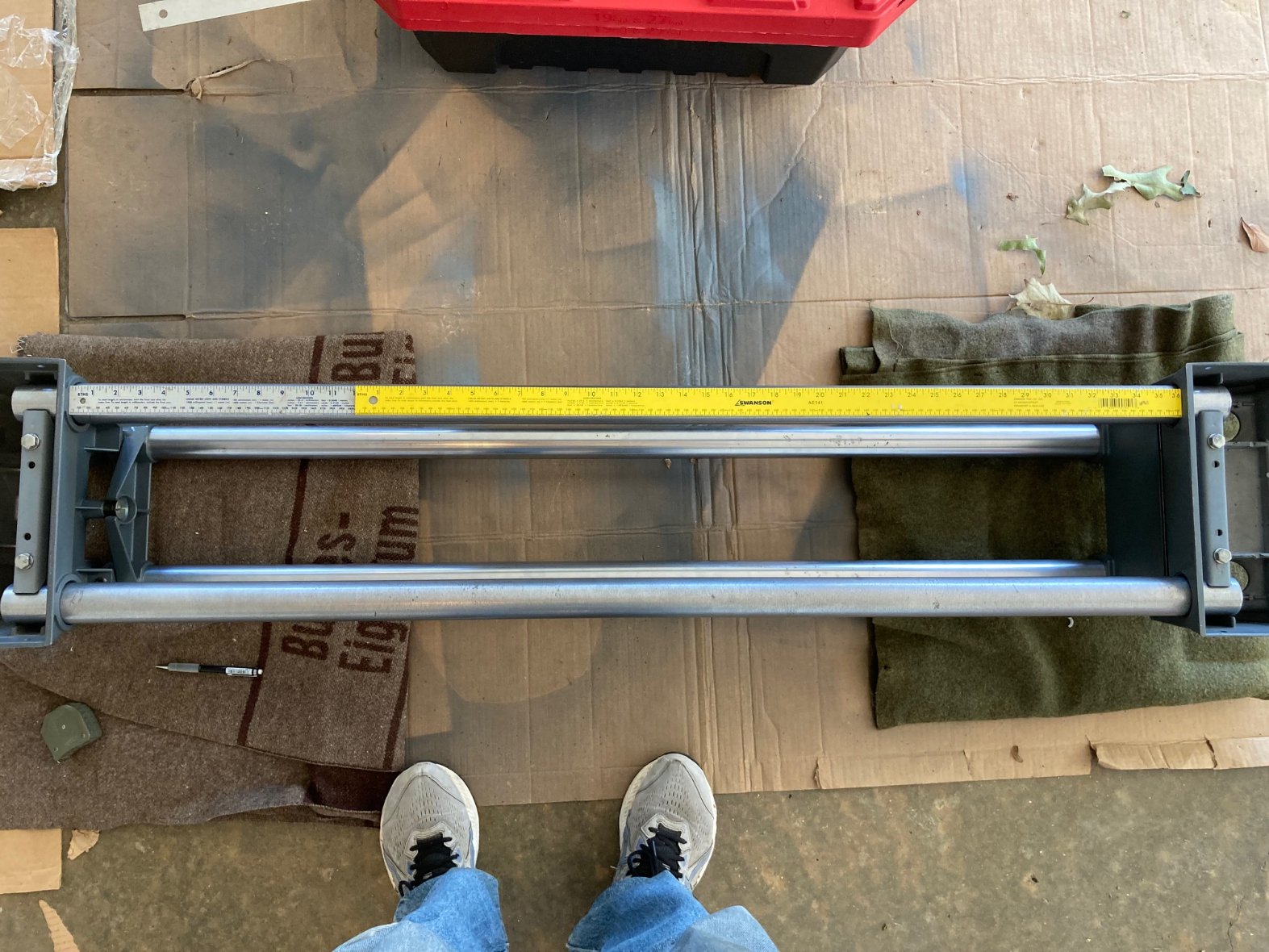

Russ, I found the thread where Dusty describes squaring the Bench Tubes in the Headrest and I took a few measurements. First, the lengths of each of the exposed Bench Tubes, from casting to casting, are identical, 47-63/64" .chapmanruss wrote: Fri Sep 13, 2024 1:44 pm The Headrest end is the adjusting point. With the Way Tubes seated in place and the Tie Bar in the Headrest the Bench Tubes can be adjusted to the proper position. There should be just a slight gap between the Tie Bar and where it sits in the Headrest. The distance between the Extension Table/SPT mounting holes should be the same front and back.
Some time ago Dusty did an in-depth look at aligning the Bench. I remember the thread but can't remember the title.
The importance of having the Bench frame properly aligned show up when changing the Extension Table from one end to the other (Base/Arm to Headrest) and having the Rip Fence still parallel to the blade.
Once the Bench is properly aligned and the Carriage and Headstock are mounted the Way Tubes can be rotated to adjust for the smoothest moving of the Headstock and Carriage on them.
The exposed lengths of the Bench Tubes inside the Headstock are also identical at 2 1/32".
Oh, I think I understand what you mean now about the distance between the Extension Tables holes now. I'll measure that too.
UPDATE: The distance between the holes are the same. (53-1/8" from inside edge to inside edge of the opposite holes and 54-3/8" from inside edge to outside edge of opposite holes).
- Update 4.4.jpg (336.24 KiB) Viewed 1797 times
- Update 4.5.jpg (346.34 KiB) Viewed 1797 times
