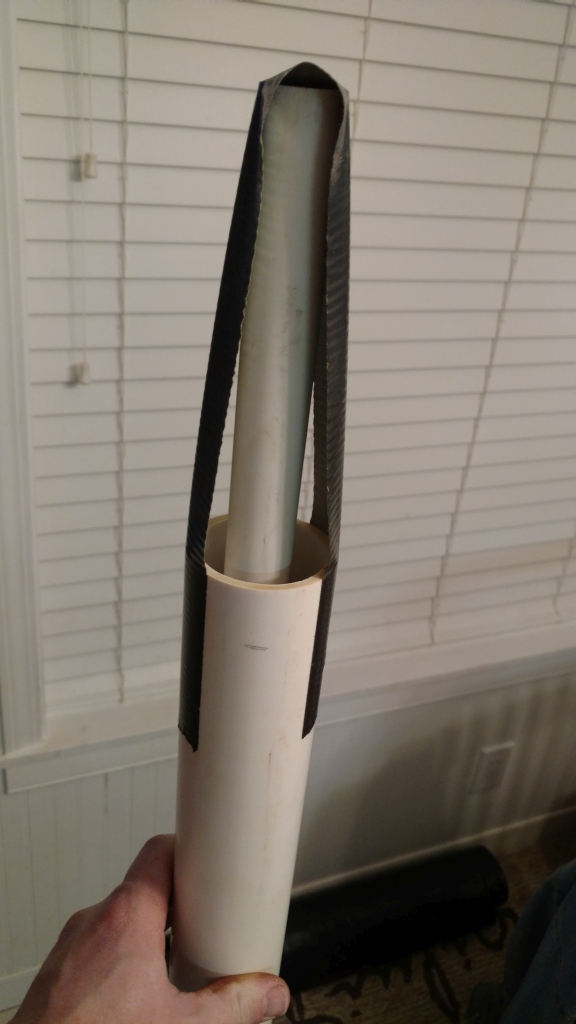

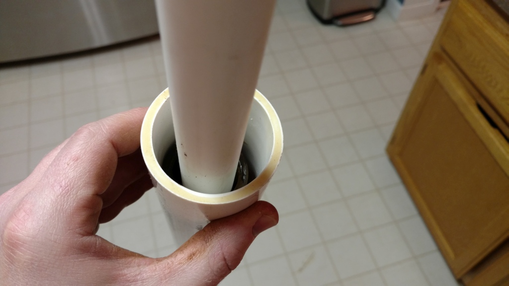

I also made the PVC pipe contraption I read about to soak the tubes (can't remember if it was here it elsewhere). It seems like it should work good.[IMG]https://uploads.tapatalk-cdn.com/201801 ... ff1cda.jpg[/IMG][IMG]https://uploads.tapatalk-cdn.com/201801 ... e6f3a8.jpg[/IMG]

To everyone who suggested using Evapo-rust before abrasive or anything mechanical on the way tubes, a big THANKS! I figured they would come pretty clean, but did not figure in a million years they would be as smooth as they are now. It will hardly take anything to take care of the minor rough spots now.
Also, if anyone can remember where the PVC pipe idea to save on volume of Evapo-rust originated, I'd like to give credit there as well. I can't find it by Google or searches here, but it was a huge help.
The first two pics are the same tube in the same spot, before and after. Left overnight, 12-14hrs.

My first exposure to using pvc pipe was when in a saw dust session, a pipe and potato was used to 'dissolve' rust on way tubes. That process took a couple of weeks.
Subsequent to that evaporust was 'discovered'. It usually works over night.
I currently use a 2" outer pipe and an inner 1" pipe to minimize amount of 'evapocash' needed.
Evaporust can be reused, but it will eventually lose the magic.
MickyD discovered why it is called evaporust. If left out, it evaporates. Interesting things can happen when it evaporates.
