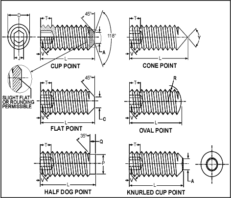

Make sure any new set screw has a flat point!:)saminmn wrote:Between new surfaces of the hex bit socket and breakover bar leverage, I got it out. I expect I need a new set screw, as this one is pretty in marginal shape now.
Thanks a lot for ideas.
Good "point" Red!JPG40504 wrote:Make sure any new set screw has a flat point!:)
Since there are actually 4 different style set screws, it would be easy to make a mess of the shaft.
NEVER rely on some one at a hardware store to know the difference. That's just downright dangerous these days.

wiredone wrote:Good "point" Red!
4 ?????
[ATTACH]16947[/ATTACH]
YA! Go to HD and inquire about half dog set screws!:D
- set screws.jpg (80.02 KiB) Viewed 2042 times
