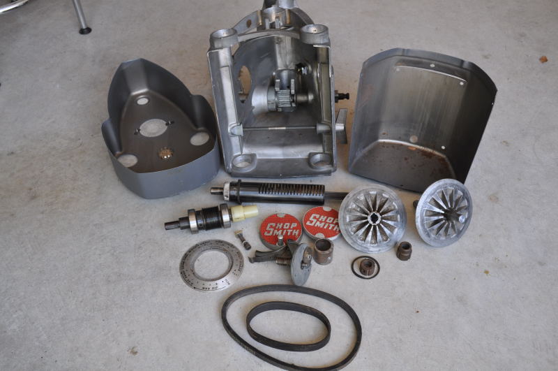

[ATTACH]17621[/ATTACH]
Spent the weekend tearing down and cleaning up my backup headstock off of my mini in preparation for the arrival of my PowerPro purchase. It will be interesting to see how many of the parts are being replaced with the upgrade. Got all the openings cleaned and waxed for easier reassembly I hope.

fredsheldon wrote:[ATTACH]17621[/ATTACH]
The only parts you will need are the three large case parts as shown - and the cover for the back side. You will get all new bearings.
