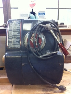

Test
Post by wrmnfzy »
Test to add attachments
wrmnfzy wrote:Test to add attachments
Good Job!
I like this more gooder!
[ATTACH]17739[/ATTACH]
