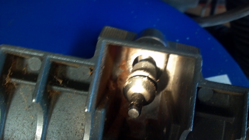

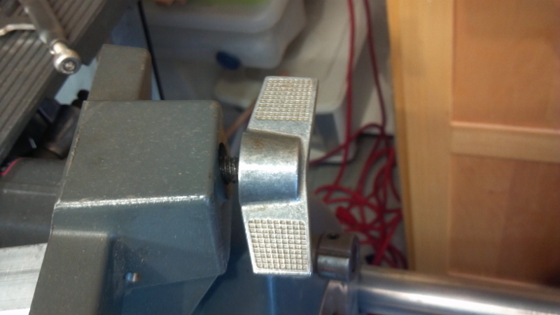

Here is the threaded sleeve that fits into the hole in the base of the Rip Fence that was twisting in the hole. It seems to be tapered but maybe not and is ribbed. I think what may have happened is the fence was dropped on it's knob by the previous owner which punched the sleeve out of it's hole. I suspect I did a fairly good job of reaming out the hole as I turned the knob a hundred revolutions trying to get it to grab and tighten up the infeed lock
I epoxied the sleeve back into the hole and drove it in with a hammer, which is what shopsmith support suggested I do. I will find out tomorrow if this fixes my problem. Also, you can see my knob does not have a rollpin to hold it on to the shaft even though the diagram shows one. I could not remove the knob even using visegrips on the threaded shaft. I suspect this part rarely fails which is why SS does not have replacement parts available.

Well the epoxy glue seems to be doing the job of holding the sleeve in place, it's not twisting in the hole anymore and I can tighten the infeed lock now. I'm suprised SS support hasn't seen this problem before so they could offer this solution to those like me. The main problem with my model is that the handle can't be removed, which is the only way to remove the sleeve and threaded rod if need be. I was able to reach the sleeve with a small stick to apply the epoxy and then shove it back into the hole. So, do I cancel my upgrade to a 520 or go ahead and do the deed. Will I be please with the upgrade.
