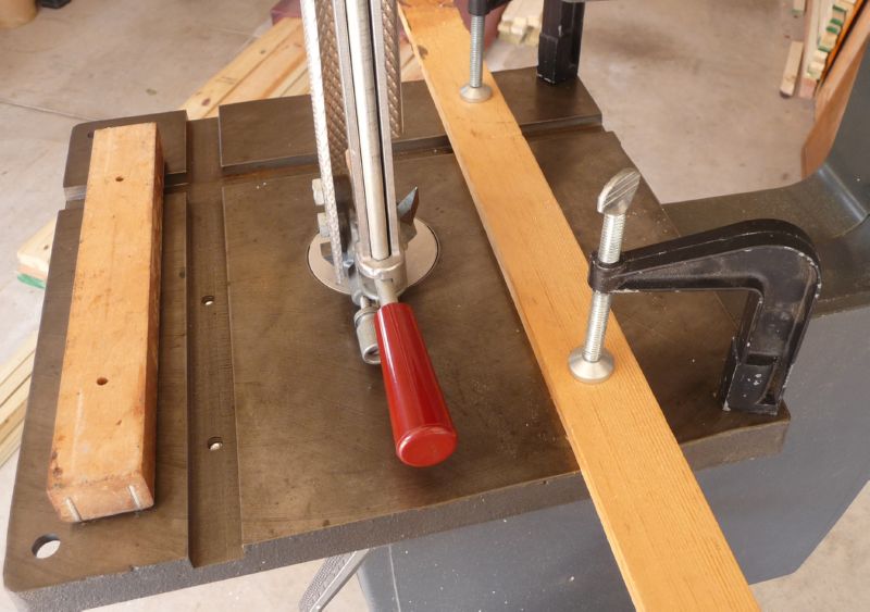

The picture shows two solutions to a fence for a cast iron table. One that I used for years is the magnet bar used to hold knives. I also use two of these to hold handsaws. The second, which uses clamps that I picked up at a garage sale 20 years ago for 25 cents each, is better because I can loosen one clamp and make a minor adjustment, whereas with the magnet bar I have to adjust the entire bar.
I drilled holes in the corners of the table and attached the clamps on the inside holes (not snugged down) so they would swivel to accommodate different width fences. Hex bolts are used to attach them. I don't know if I will ever use the outside holes but they are there if I come up with an application.

I have never had to worry about a special fence for my cast iron band saw table. I have always had good success using the miter gauge with an auxiliary fence attached as detailed in the band saw section of Power Tool Woodworking for Everyone. Always worked like a charm for me.

I've also had fine results with a strip of something straight, and two clamps to hold it to the table. Be it spring clamps or screw clamps.
Works just as well on the drill press as a locating guide when I want to poke holes repeatedly, and as a faux router or milling machine, when I want to slide things past.

+1 on this solution. I have the newer aluminum table (but not the fence). I have used two spring clamps to hold a piece of 1 x 1 "angle aluminum" I got at Home Depot for a few bucks. My rips are straight as long as I am careful to make sure I set the fence up parallel to the blade. If I did a lot of ripping or resawing on my bandsaw I would think about investing in one of the fences Shopsmith offers but I don't do it enough to justify the expense.foxtrapper wrote:I've also had fine results with a strip of something straight, and two clamps to hold it to the table. Be it spring clamps or screw clamps.

When using the fence on a bandsaw to rip, why does the fence need to be parallel to the blade. Since nearly all blades have some degree of drift, I would think that this setup would not require that.
Maybe you can tell. I don't use the rip fence on my bandsaw. Free hand or table saw for rip cuts.
Dusty, I know a lot of people have drift and spend time skewing the fence to correct for the drift, but on the few occasions I have used the bandsaw to rip, I haven't observed any drift on my bandsaw. So I just continue to set my improvised fence parallel to the blade.dusty wrote:When using the fence on a bandsaw to rip, why does the fence need to be parallel to the blade. Since nearly all blades have some degree of drift, I would think that this setup would not require that.
