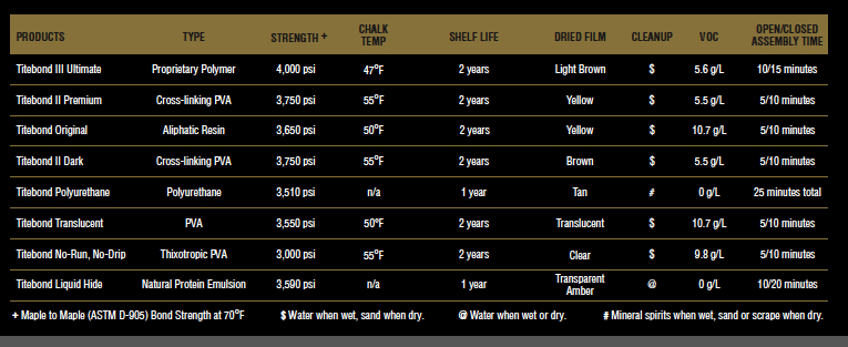

Here are the of characteristics Titebond, but I would imagine that other similar brands should have similar specs. Doesn't look like they list the specs for the extend version though.
[ATTACH]18398[/ATTACH]
Picture 8.jpg (259.58 KiB) Viewed 2190 times
