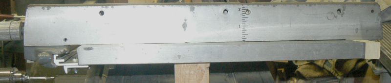

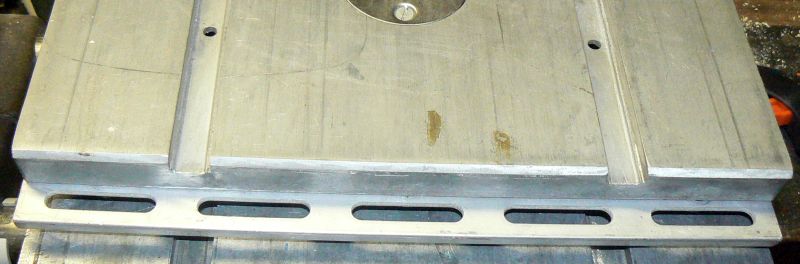

I recently acquired a few Mark 2 parts including a work table. The table is the same width as a Mark 5 table, but is shallower by 1" and has a different fence rail on the front.
[ATTACH]18512[/ATTACH]
First alteration is to mount the original rail upside down.
[ATTACH]18513[/ATTACH]

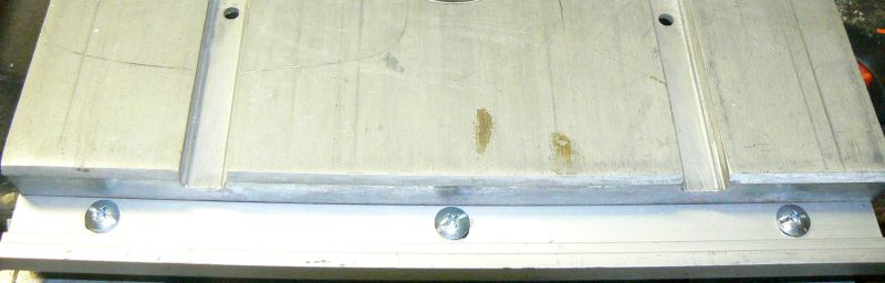

Next a Mark 5 rail is screwed onto the Mark 2 rail.
[ATTACH]18514[/ATTACH]

Modifying a Mark 2 table to work with Mark 5 fence
- m2 table b4.jpg (95.39 KiB) Viewed 305 times
- m2 table step 1.jpg (62.47 KiB) Viewed 307 times
- m2 table step 2.jpg (54.63 KiB) Viewed 308 times

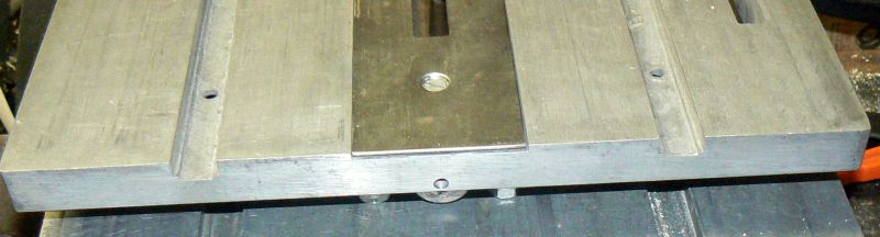

The table is 1" shorter front to rear. It has a tapped hole in the center that has 1/4 - 28 threads.

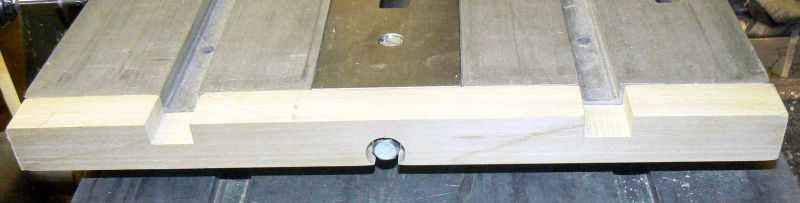

I attached a 1x1 wood spacer to the rear with a 1/4-28 cap screw. Notice the miter bar clearance notches. I may use carpet tape to prevent shifting position since only the screw in the center holds it in place. Eventually the wood spacer may be replaced with an aluminum bar.

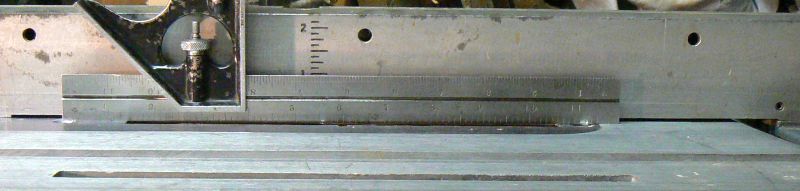

Lastly a Mark 5 fence now functions with the Mark 2 table. I may need to shim the Mark 5 rail from the looks of this pix. The fence appears low in the front.
[ATTACH]18517[/ATTACH]
I do not know if the quill shaft is in the same location(front to rear) as a Mark 5. Time shall tell!

- m2 table rear b4.jpg (55.87 KiB) Viewed 305 times
- m2 table rear after.jpg (53.16 KiB) Viewed 306 times
- m2 table ala fence.jpg (46.02 KiB) Viewed 305 times

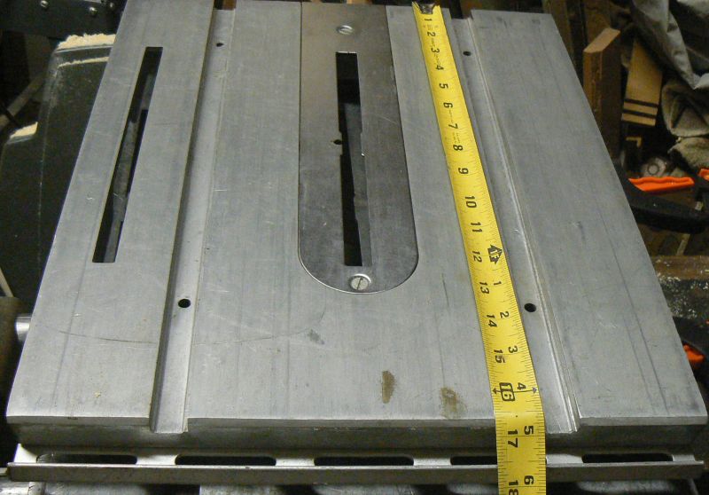

Shimming evened things out. The quill will be 1/2" closer to the front of the fence.
[ATTACH]18518[/ATTACH]
I presume the 'hole' in the table insert establishes the quill location. That and the insert itself.
- m2 table shimmed.jpg (55.68 KiB) Viewed 310 times
