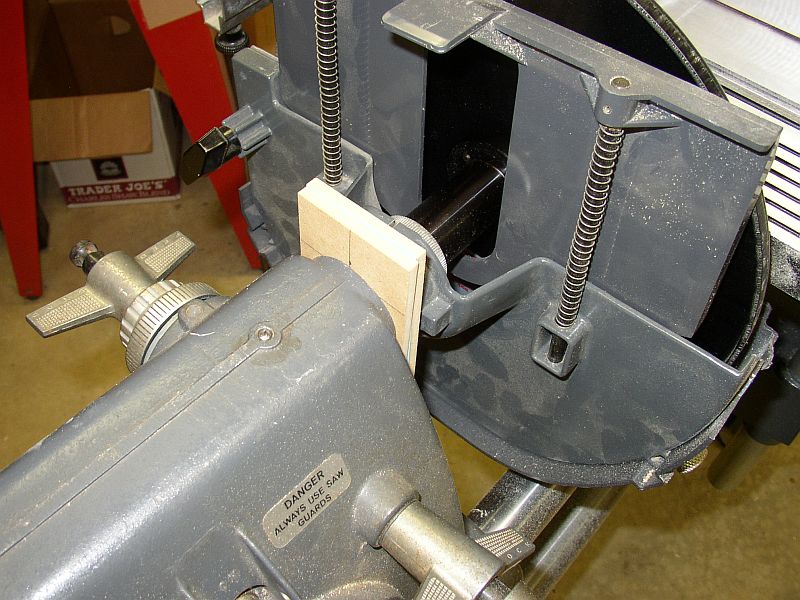

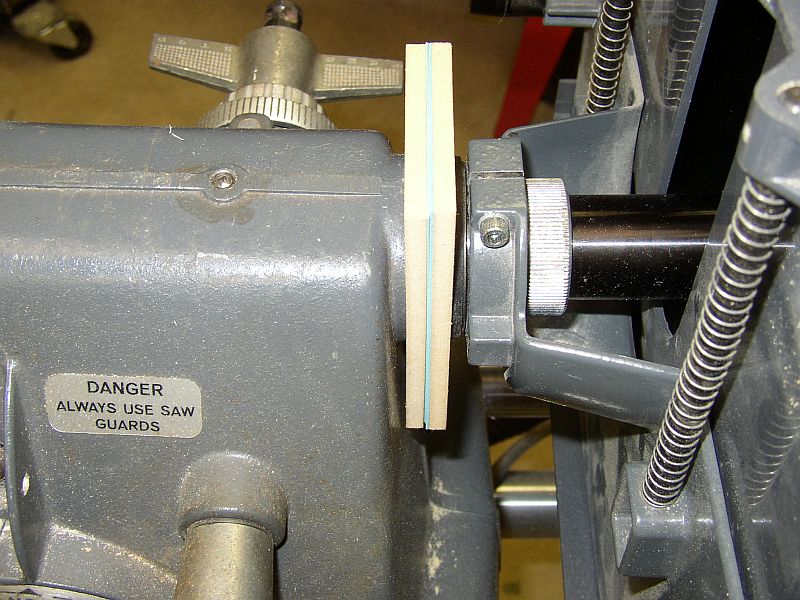

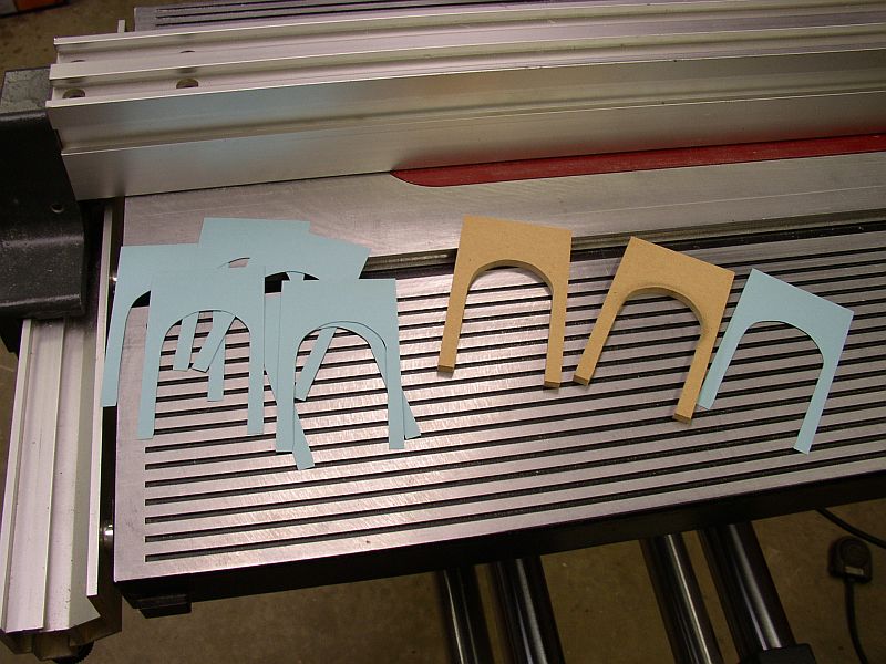

I decided to make a set of shims and give it a try.
I pad cut the shims on my scroll saw by pad cutting them between two pieces of 1/4" hardboard. This worked well and in a flash I had about a dozen shims. The card stock I used measured .0075 so if I stack two together it's pretty darn close to 1/64".
I decided to use the two 1/4" hardboard pieces as the base point and adjust from there. So, I inserted the hardboard retracted the quill until it compressed the rubber washer, let it go and then tightened the quill. I set the fence from there for my first cut. Subsequent cuts were made by adding shims between the hardboard pieces and turned out very predictable.
I can now make my incremental cuts quickly without futzing around.
I am very satisfied with the results.
