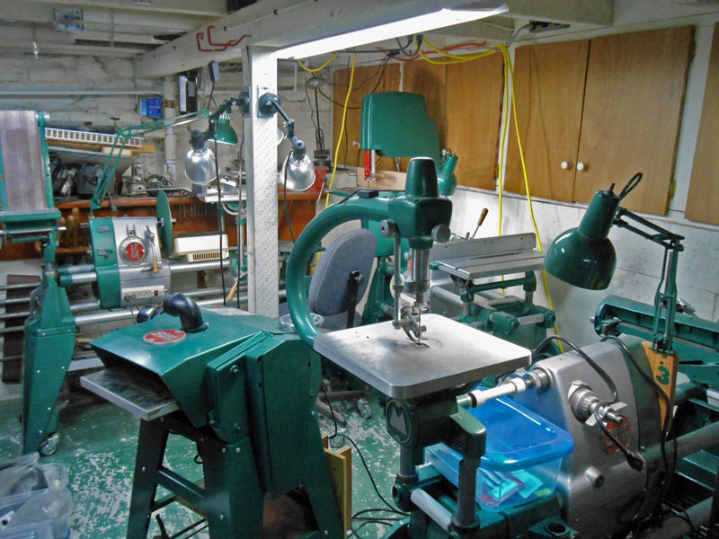

So I set out to re-do my three SS's. One I bought new in the 70's, a gray. Second a used goldie I bought in the 80's and the third is a greenie I bought this year after the belt broke on number 2. Here's the results.

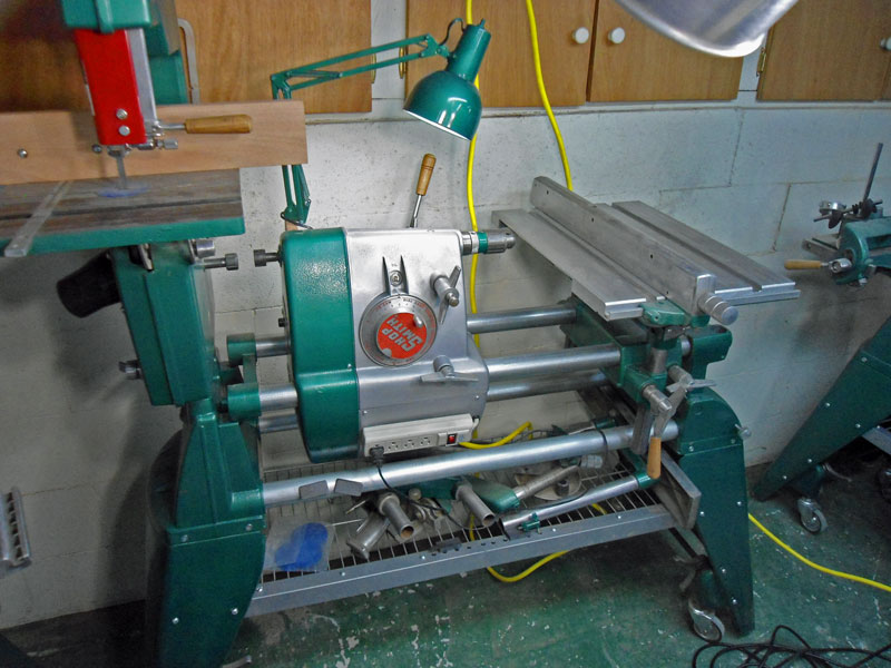

The goldie & greenie I cut down to shorty's and my plan was to use them as power stations for the accessories, and the gray one I shortened by 4" so it could be vertical in my low height basement.

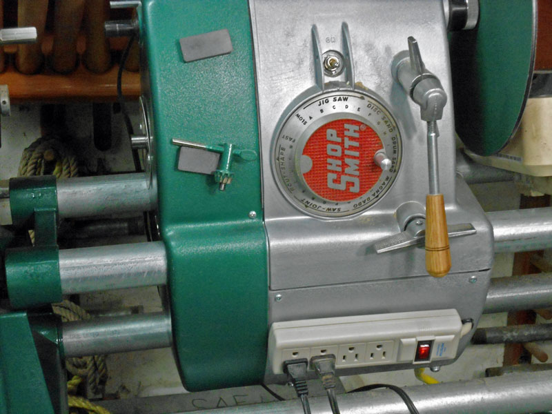

I wanted all to look the same and one of the things that was different was the control handles. My newest one had long tapered red plastic handles and back when, I changed the handles on the goldie to match. The greenie had the short red handles. And looking to buy replacement from the factory, I discovered now they are all black. So decided to make my own with oak handles to match on all three machines.

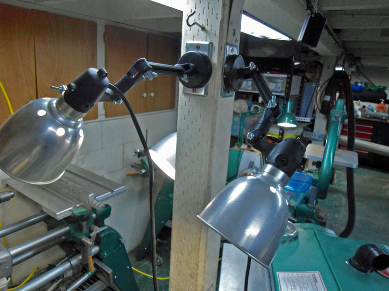

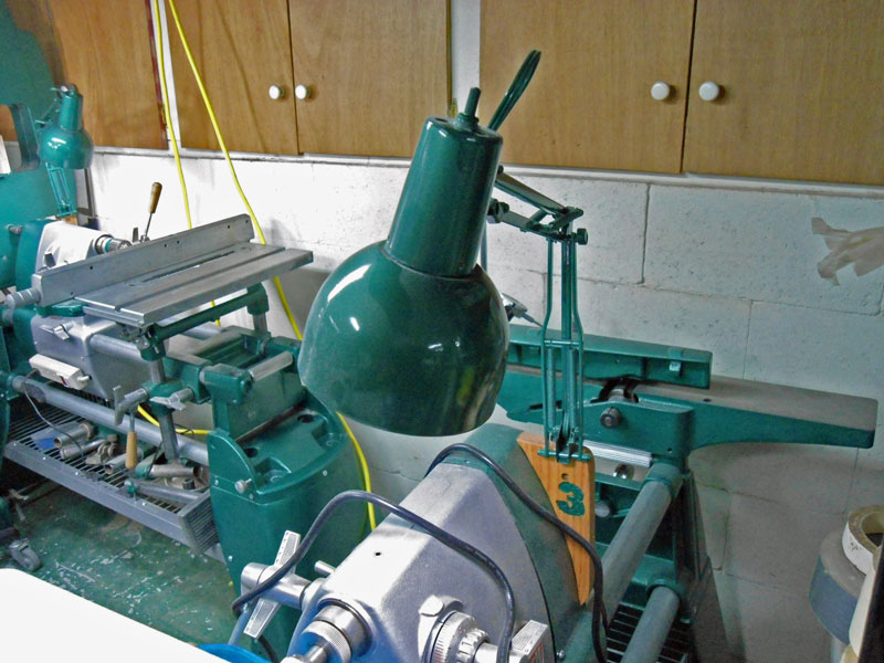

Also wanted more light in the basement. So I made wood brackets to hold swing arm lights. Numbered the brackets to ID each machine. Needed an outlet to plug the lights in so added short outlets from HFT to the headstock.

While I had the SS's apart, replaced all the bearings & belts. Replaced the power cords with 12AWG and new power switches. Finally after I got all three back together, read about the bandsaw. Ended up putting a window & vacuum port on it, and new self printed SS logo over the Yuba one. Replaced the old broken saw guard it had as well and put guide bearing in it as well.

One of the things I found was magnetic mount swing arm lights. I mounted steel electric cover plates all over my shop, so I can increase the light where needed.

I also really like your lights and the light mounts you put on the belt cover.

Those mag lights are from HF as well, no? I use them with cover plates just like you did. They are a great addition and can move easily to another cover plate at a moment's notice.
