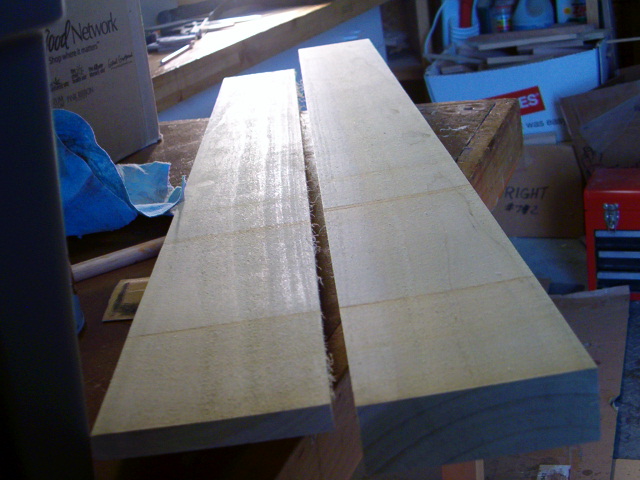

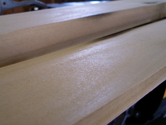

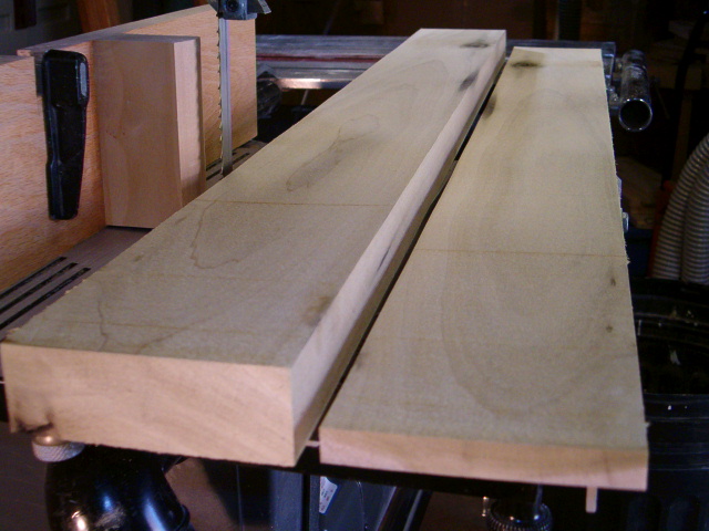

Also, today I had an opportunity to use my SS 5/8" resaw blade. It worked very good. I tried to take some photos of the smooth straight faces that resulted. Resawed was a poplar 5/4 board 3 3/4" wide. I thought of the pics after seeing some others on this forum. The speed used was 1000 RPM. I used my shop made single point fence. The only tel tale signs of resewing were the slight burn marks where I stopped moving the boards in order to change hand hold.
[ATTACH]19311[/ATTACH]
[ATTACH]19312[/ATTACH]
[ATTACH]19314[/ATTACH]

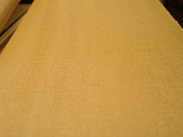

HERE IS A CLOSE-UP
[ATTACH]19315[/ATTACH]

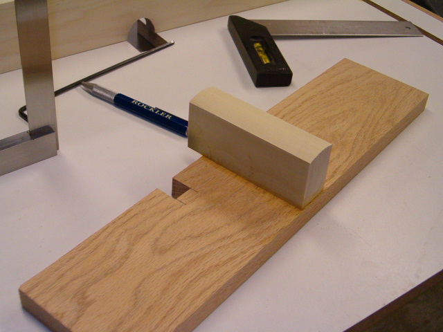

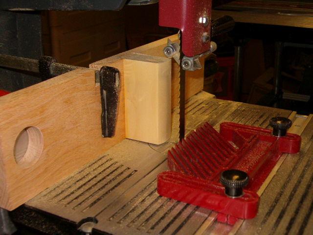

Can you give a few shots of the single point point fence. I only have the older steel table and I need to come up with something here.
R Hart
mrhart wrote:...Can you give a few shots of the single point point fence. ...
Happy to! First here is a thread from early this year. There's 2 pix in there plus a narrower point from old
https://forum.shopsmith.com/viewtopic.php?t=3050&highlight=single+point+fence
Before adding 2 more more pix, you should know I tried to copy the wide slope of the Kreig single point add-on to their straight fence. After doing some more reading on single point fences, I think I will try a narrower point.
The only trick in making one is to make sure the point will be perpendicular to the table. Then I had to saw a notch to hold a clamp that will close firmly on the aluminum fence.
[ATTACH]19328[/ATTACH]
[ATTACH]19329[/ATTACH]

JPG40504 wrote:With the steel table, the miter gauge becomes the fence.
It might make more sense to make the 'jig' clamp to the table itself.
I will see what I can throw together this weekend. Would 1/2" wide for the single point be too thin?
I have some 3/4" african mahogany that I want closer to 1/2" and hate to waste it on the planer :eek:
R Hart
mrhart wrote:I will see what I can throw together this weekend. Would 1/2" wide for the single point be too thin?
I think the nose radius is the critical thing, not the thickness. However the thicker it is, the more rigid it is.
I think a chunk of 2x? would be be preferable.
It HAS to be square/parallel to the table/blade.
