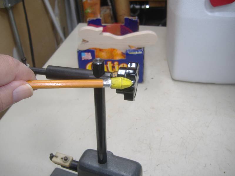

First was a pretty easy fix, a replacement of a cracked cutter adjusting knob on the tool rest that is part of the lathe duplicator.

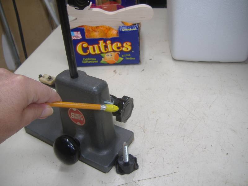

On the same tool rest a know was missing, it is added to the set-screw to make it a hand operation rather then having to have a tool to do the adjustment.

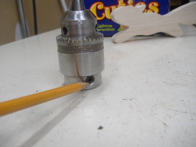

The lost setscrew for the drill chuck was next on the list. It will be nice to have another chuck in service.

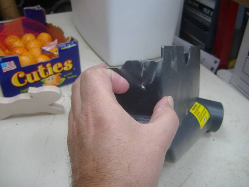

This dust collector part had just a small nick in it and it began growing. I drill a stress relief hole which seems to have stopped its progress. A $14.11 item seem like it would be worth the price to have a new one.

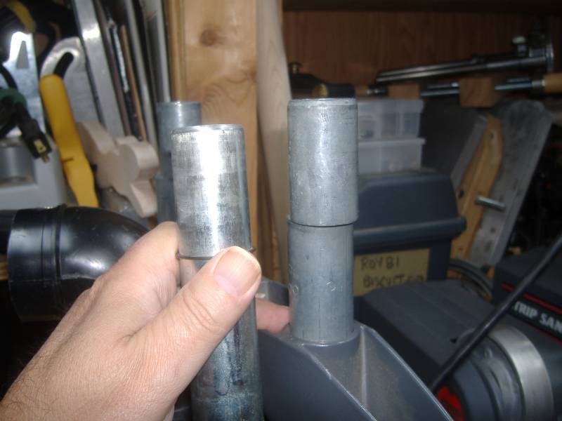

Back in July of 2010 I miss placed the legs for the strip sander, I kept thinking they would turn up. I gave up and got a new set so I can get it back into use.

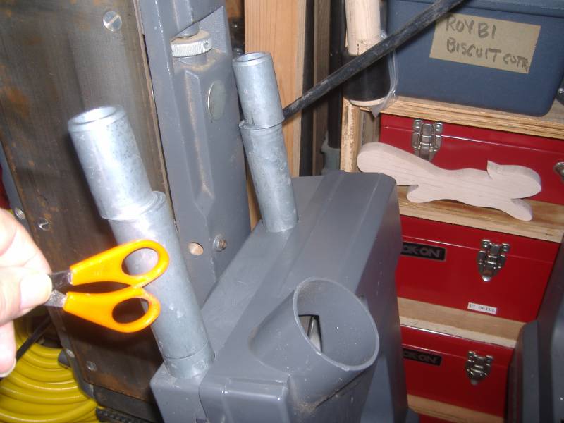

My belt sander is old school, not having the eccentric legs. My shopsmith has now been upgraded to the dual tilt that expects the SPT's to have eccentric legs.
I picked these up a while back and though while I was at the other projects of the day I get this done. Actually the belt sander is in need of a good cleaning and I want to pull it apart in the spring and "tune it" but I did not want to loose the "new" legs, 'cause that has happen before.
[ATTACH]19460[/ATTACH]
I still need to work the eccentric leg issue on the old jig saw.... I don't have a solution to that yet.
